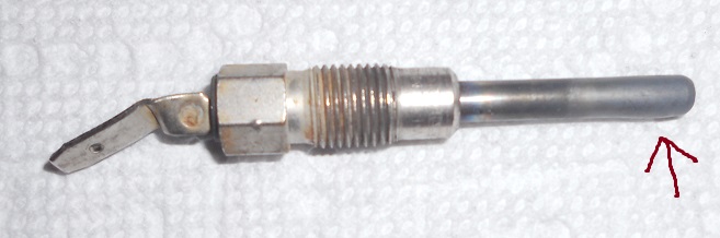

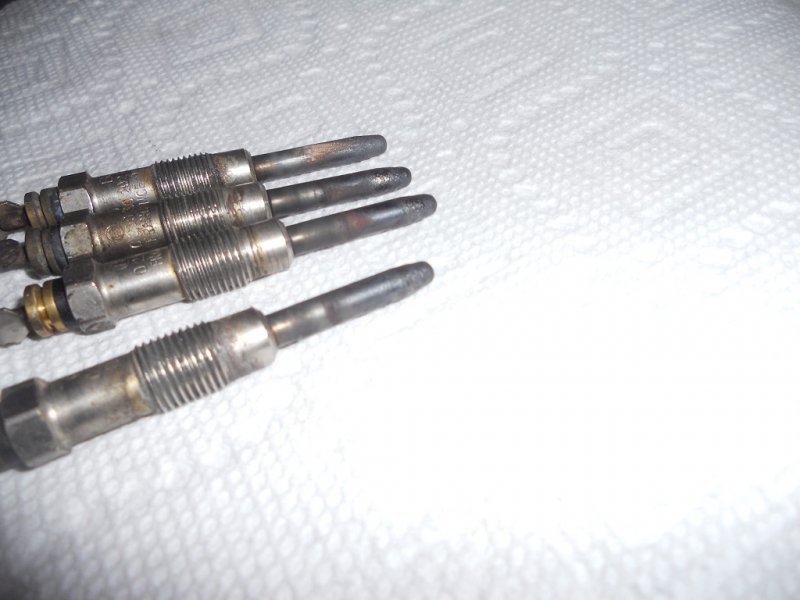

Looking over my collection of "useless" glow plugs removed from several engines I find that the casings appear to get a rust like texture here and there. So this condition isn't specific to me. I don't know if what is pictured is what is referred to as erosion or not.

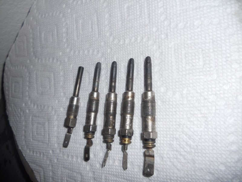

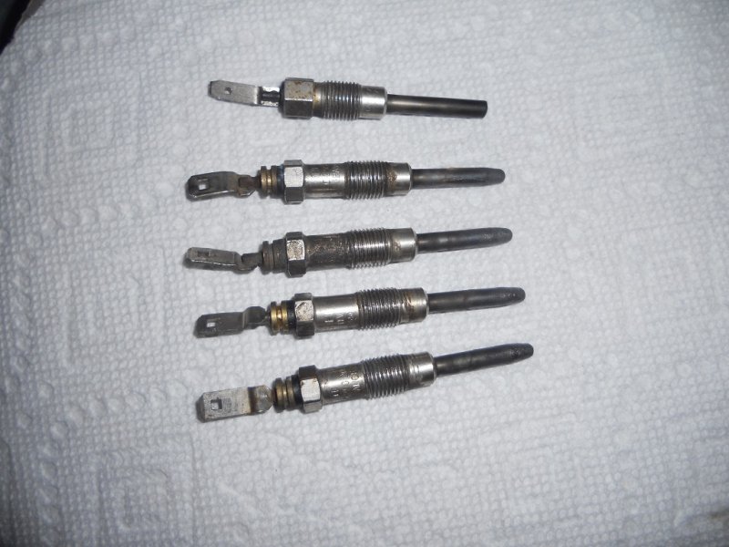

For reference a clean used Wellman plug is on top with 1 good and 3 bad Duraterms.
For those that are thinking about running surplus or old Wellman's 070... Don't. Just lock one in a vise and power it on. I watched one swell up!
