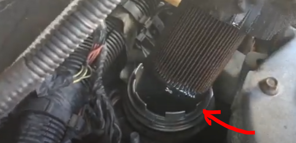

The old style requires the original retaining ring
The newer style comes with its own built in ring
It looks like it actually comes with this new seal with WIX
I don't remember seeing a new o-ring in the Baldwin box.
Do both require a seal on top of the FFM?
I've replaced these a number of times and can't recall what is needed. I've used both styles in the past. Currently, I'm using a Baldwin similar to the one I'm calling the new style and I didn't use any sort of o-ring or flat rubber seal where the red arrow points. Is that a correct installation? Later, I tried again with the flat rubber seal and I am seeing the same results.
I have a leak at the FFM that I can't seem to pin down but it seems to be coming from the top (not the bleeder) so I'm trying to see if I've installed the filter correctly.

I too would like to know what the differences are. after the FFM on the 93 just randomly decided to leak like there was no tomorrow. it had the one with the built in cap and ring. I think it has an o-ring up inside the cap where the old metal style used a flat rubber sealing ring. This area is exactly where mine blew out fuel. after swapping the cap + filter with another one I had (used but still good) the leak remained and I bypassed the FFM with an inline filter temporarily.
