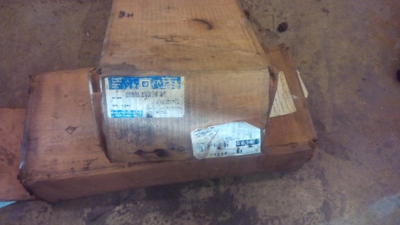

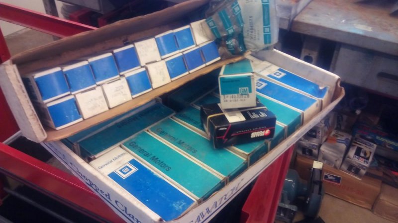

So I found some brand new still in the box from the dealer heads here locally for a pretty good price, $400 for the pair. So my ?s are
1: are there any original castings to avoid
2: it has 1 dot precups which are NA so if I have them machined will it still leave me at the higher NA compression ratio or will machining the mouth drop it to turbo levels? I'm assuming it will not drop it as much as I'd like.
3: these heads are not assembled but come with all the parts in the original factory packages, so my ? here is what's the best valve stem seal to use?

Picked up those heads
