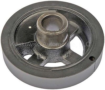

Very best choice is Fluidamper and good for over 800,000 kilometers. http://leroydiesel.com/products/fluid-damper-for-ds4-or-db2/
Whenever you replace the balancer, you replace the belt drive pulley also. Best option for that is this: http://leroydiesel.com/products/billet-crankshaft-pulley/
If you cannot buy from Leroy, find a source for fluid damper or buy both parts in AC Delco.
It reduces the harmonic and torsional vibrations of the crankshaft.
For some engines, not all, It is a counterbalance for the crankshaft. The difference is what is known as an internally balanced or an externally balanced System.
The Harmonic Damper on the front of the engine is a damper only. The Damper does not have anything to do with balance.
I think you'll find the harmonic balancer is part of the engine balance. It has a built in weight on one side so it's a dual purpose item
