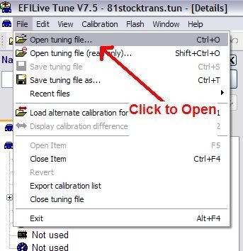

First you will want to find your stock tune on your computer and rename it to say "stocktune2". (You will find out later why not to work off of your stock tune) .
After renaming your stock tune. Open up your "renamed stock tune".

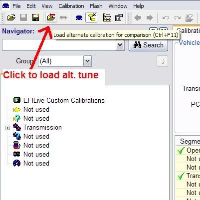

After opening your "renamed stock tune", we will need to load the tune that you would like to adapt to your Operating system.
To do this, go to "Load Alterative Calibration" (See Picture)
After loading you will see in the heading menu your "Renamed Stock Tune" with something like this: (alt: "loaded alt. calibration:)

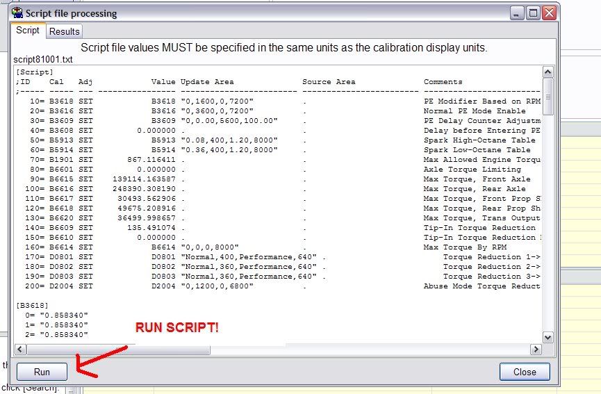

As you notice. It breaks down the changes in the comparision menu. Instead of manualing copy and pasting each change. You simply run a script.
First, we need to create a script:
After script has been created, press Save.
Then go to run scripts:
You will select the script you just saved to run. Then click run:
After the script has ran. You will see "Done" in the processing screen.
