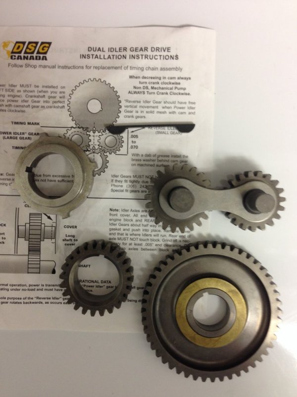

I found one new in the box in my garage today. This one fits the 6.5L with electronic injection and therefore has the inductor wheel. What are these going for?IMG_0727.JPG
Consider that these items only appeal to the few.
If the goal is to get most / all the money back, prepare to wait. If the goal is to just let them go and recover some 'found-money', auction them.
I originally bought it from Kennedy Diesel but they no longer list a price for the drive. So, unless it has value over the next best product in the market, which appears to be a drive offered by Leroy Diesel, the pricing would indicate something less than $360.00

Alright, $102!
