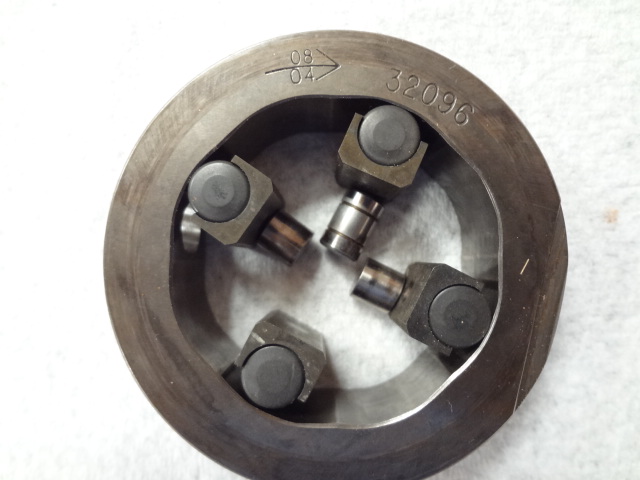

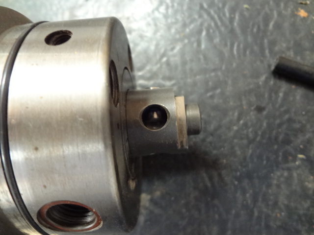

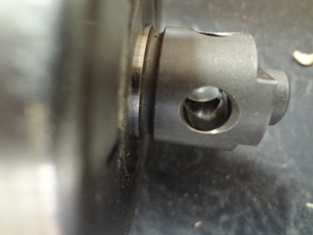

Not a whole lot of meat left in the web of the rotor thingy. I have one in pieces if you want me to post for a visual.

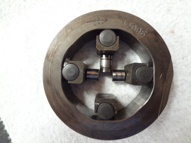

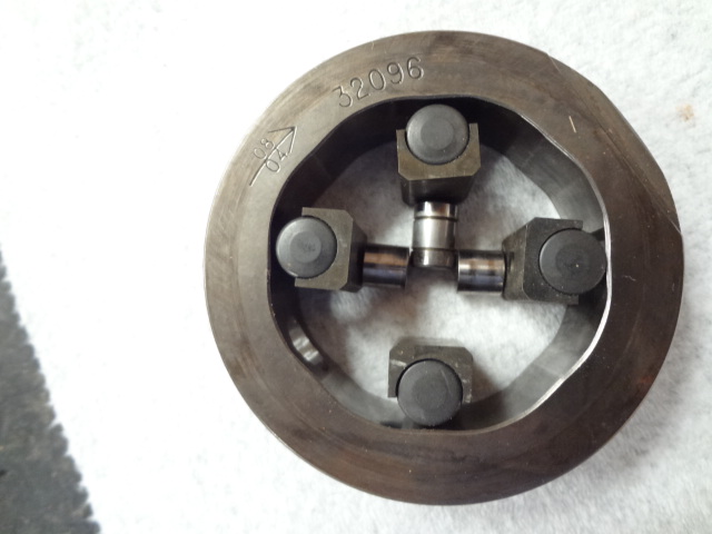

On the rotor the outside diameter appears to have material but not sure about at the inside diameter. I seemed to have lost the other long plunger but here is a picture minus the rotor. If you increase plunger diameter you would have to increase cam lobe diameters I think or they might collide????

The length of short plungers might could be shortened in relation to increased diameter and or increase in pitch diameter of cam ring??? May be doable but I don't think its as easy as increase plunger diameter and increase plunger bore diameter????
