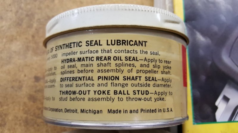

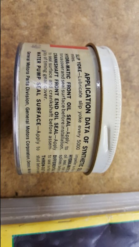

Got slip yoke clunk pretty bad in the wife's '07 Tahoe.
I see we are supposed to use Steelco Industrial Lubricants Inc. 488-1 Red Crown Lubricant. Any good alternative?

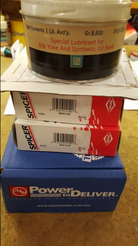

I ordered the GM lubricant because it's compatible with Auto Trak II transfer case oil that I will be draining and refilling but the real fix is the replacement Spicer nickle plated slip yoke. I ordered one from Drivetrain America along with a couple of new U-Joints while I'm at it.

GM grease should be delivered today. I'm not doing the work until next weekend though. I have the yoke and u joints already.

I did the TC and rear differential fluids along with oil change and lube. When I pulled the wheels to do a tire rotate I saw that the rear brakes were completely shot, I already had the pads for it so those got done. I was pressed for time and not real confident on doing the slip yoke end u-joint since it didn't have snap rings as locators so I just lubed up the spline and reinstalled the driveshaft. The grease worked. End of clunk... Surprised me. I'll see about getting somebody that has done the front u-joint before to do it. My little 16T press didn't seem to want the job and I didn't want to wreck the drive shaft.
If its the one with no snap rings, you need a torch to do them. If yout them in a press, you'll just break the ends of the driveshaft. GM glued them in with a nylon rope material, you have to burn it out to do the u-joints.
Yeah I figured they were gonna be too difficult and I ran the risk of wrecking the driveshaft. I wondered about the nylon plugs. Now I know. I only put enough press force on them to see if they moved and before I saw any deflection of the ear.
