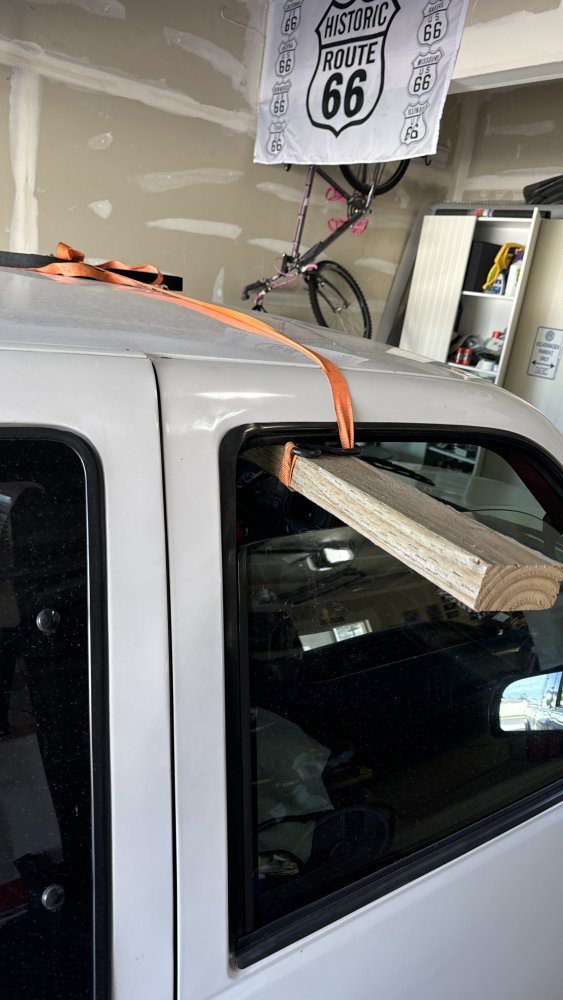

Finally got around to replacing the driver’s side hinge pins. Door was sagging and very difficult to close. It required so much force to slam it shut the door panel would stay attached.

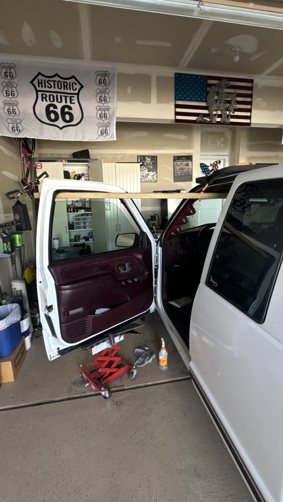

Only challenge was securing/suspending the door after pulling the old ones. I rigged a 2x4 through the open windows and used a tie down strap to make up for not having a cherry picker.
Worked ok but, still needed the wife to help out. She’s used to hanging doors through her old job in home construction.

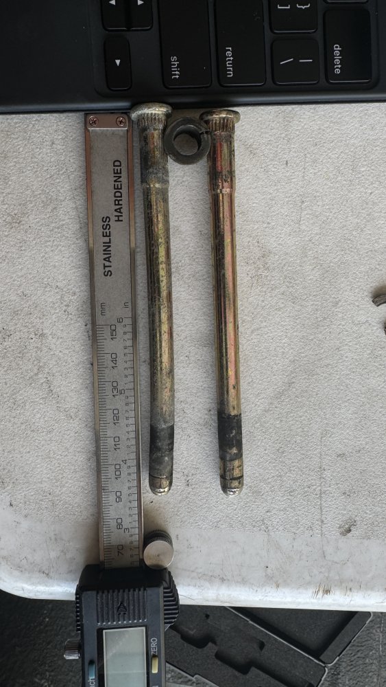

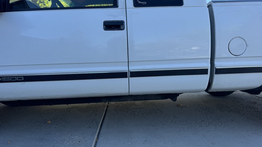

The doors sagging was easily explained when the old pins were out.
