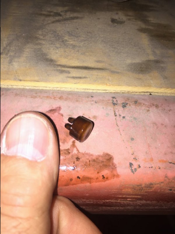

A friend going into his kids dodge engine oil pan found this plastic thing. Anybody know what this is? Or where to find pushrods,lifters, etcimage.jpg
It goes into the pickup screen. It spaces the screen off the bottom of the pan. Common engine killer, it pops out and pan bottom flexes up. Oil starvation and boom.
