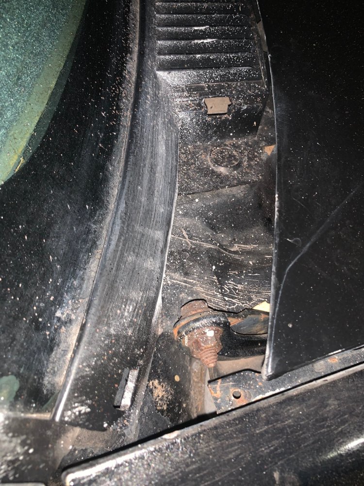

I made a discussion on the GMT400 forum but thought I'd cross post here, as well as I'm mostly worried about moisture near the ECU
You can see my full images here but the short of it is that I'm getting a mildewy smell up front on the passenger side now that the weather is wet/humid, but am not seeing active water intrusion; only condensation building up. All the drains are clean and no cracked body seams, but I am going to silicone the screws as a precaution. I wonder if the condensation might be more of an indicator of an air gap in the windshield seal.
You might want to check the windshield seal for signs of deformity, age etc. causing leakage around the sides and bottom. Difficult to ascertain but, its possible. Leaks at the tops running inside would be visible inside the glass (current issue of my own).
The further up the firewall the carpet is damp would help isolate the source coming down from above or up from below through a compromised body plug in the floor panel as they rot out far quicker than the actual floor..
I had a leak in the same area on my truck, only later to find out even the headliner around the passenger side sun visor was getting wet. later I discovered the rear brake light seal was cracked. water was traveling all the way up and down to the front passenger area on my crew cab!
if not, I'm with Paveltolz, you can use black RTV in and around the windshield and be able to hide it. also under the wiper plastic cowl where the cab has seam sealer. look it over good. it can be something as simple as a self tapper holding something on the firewall under the hood in the wrong place too!
another place to look too is under the carpet for drain plugs. driving on wet roads and moisture gets in, evaporates into the rest of the cab.
Spray foaming glass cleaner around the outside perimeter of the glass and then blow compressed air from the inside to see if any foam is affected.
