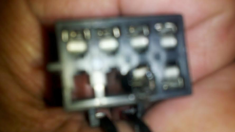

I found the fan/blower problem. It was a melted connector on the blower switch. It's not focused. but you can see the issue.

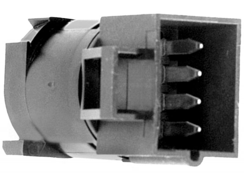

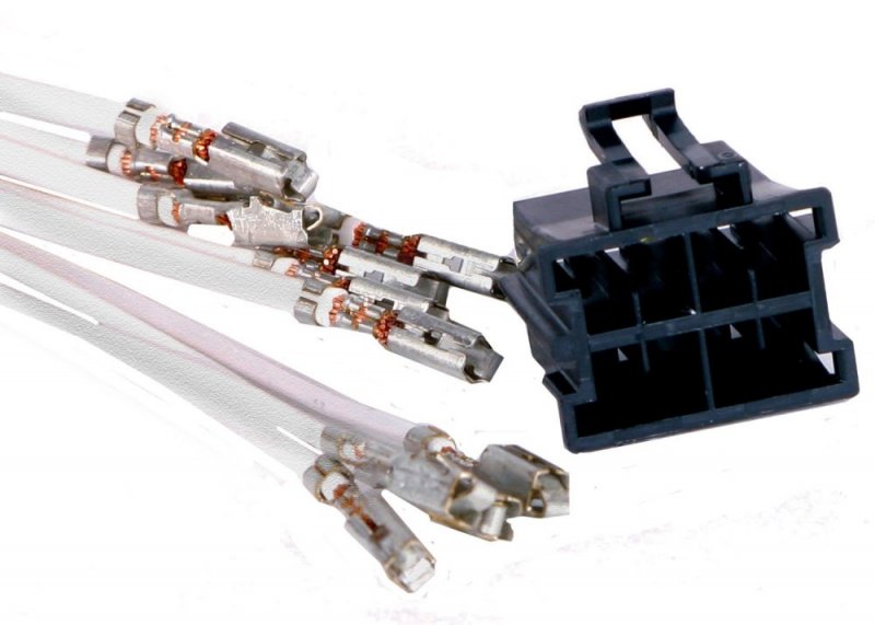

Here's what I replaced it with.

I would add a ground strap to the blower motor. IMO some cases of the melted connector issue is high current draw from a bad blower motor. If this melts down again I would replace the blower motor (AC Delco only as the knock off motors are louder) and get a larger gauge wire for power bypassing the connector. GM is famous for too small wiring and connection problems to the HVAC blower melting down.
Did you also replace the blower switch? The switch has a seperate output to power the compressor portion of the circuit, and agter seeing that connector, I would wager the switch might have gotten toasty to. If you did, the next big problem would be the low pressure switch since GM were idiots and let the switch carry the clutch current instead of using the relay like every other car out there does.
Yes, I replaced the blower switch and the plug kit came with some heavier wires and some lighter wires. I used the heavy wires in the slots that melted.
