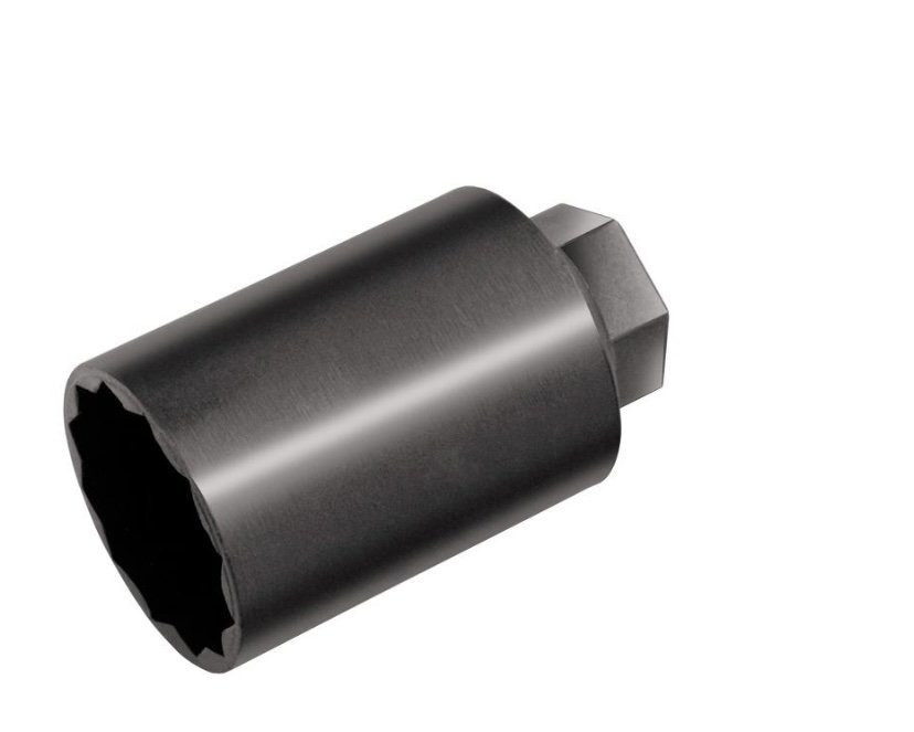

www.accuratediesel.com
This company has made their own injector socket for 6.2 & 6.5 diesel. See the edges of the injector are not shaped like a nut. They are more rounded corners. The only thing wrong is that they made it to fit a 3/8" drive. You can not use a 3/8" drive next to the turbo on a Trek. It's great for the other 7-injectors.
I would like to cut off the top part and mig a 5/8" nut there. The other 6.2 and 6.5 sockets they make are 30mm. It looks like a 12-point or more like a box wrench and it may slip around the injector when you put pressure to it...which wouldn't be a good thing!
I sure would like to find this one from NAPA that they don't make any more. Because I know it works- on a Trek motorhome like mine. (Napa Part # BK700-2470)
The length of the socket is "KEY" for that one injector. And it can easily do the other 7 injectors.

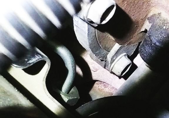

He can’t make it longer. This is why he can’t use a ratchet on it. There is no place to run extensions through. This is a common issue in RVs & Pvans.
Attached is a picture of my one injector that has a space problem next to the turbo.
Anyone that's working on their injectors...can you take a measurement for me. Can you measure the injector still in the head to the top of the injector with the hard fuel line disconnected? This will help me because I haven't disconnected the hard lines yet.
The adapter wouldn't have to be near as thick as a ratchet head.
Might be able to get by with only a jam nut thickness.
I think at least one of my 30 mm sockets has a hex on the end.
OK guys! My injector socket came in and ready to move on. It's the OTC 5060 socket like the socket shown above that others have suggested.

After getting everything prepped to start pulling the injectors...I bought the OTC 5060 socket. The passenger side is really tight to work on. After hours of messing with this side...I did get the 4 injectors loose. This is the socket you need to have- It works!
