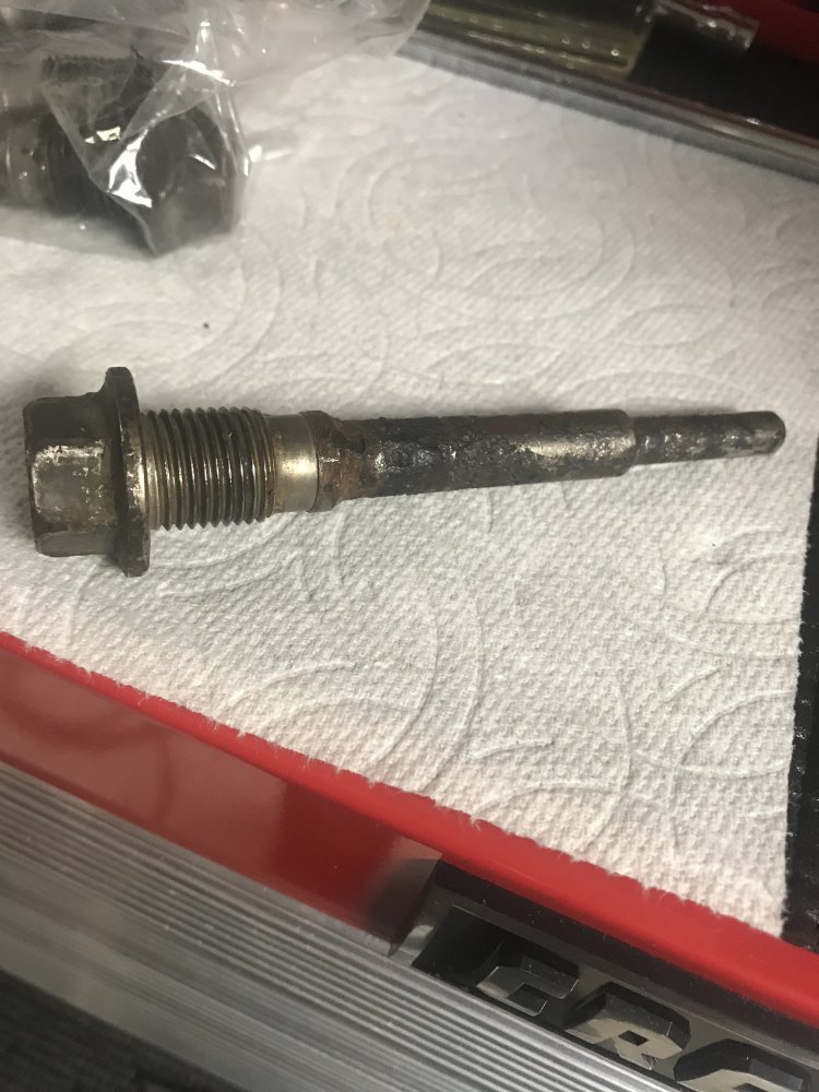

Just a quick update... I ended up inspecting the front calipers a bit more. It turns out the top caliper slide bolts on both sides looked like they had overheated at some point (see attached). So I looked inside the caliper brackets as well, and sure enough the top slide holes on both sides were also distorted. I ran a small angled pick through the tops and it was very rough; the bottom holes were smooth as glass. I'm assuming this was causing drag and preventing the calipers from sliding correctly.
So I replaced both caliper brackets (decided to use Cardone 14-1125 and 14-1126 reman), and all 4 bolts and rubber sleeves (tops were also a bear to get out), along with plenty of high temp grease. And they work great now. So thanks again to @Will L. for making me reconsider inspection of the sliding pins! And no more faulty ABS engagement either. 👍🏻
