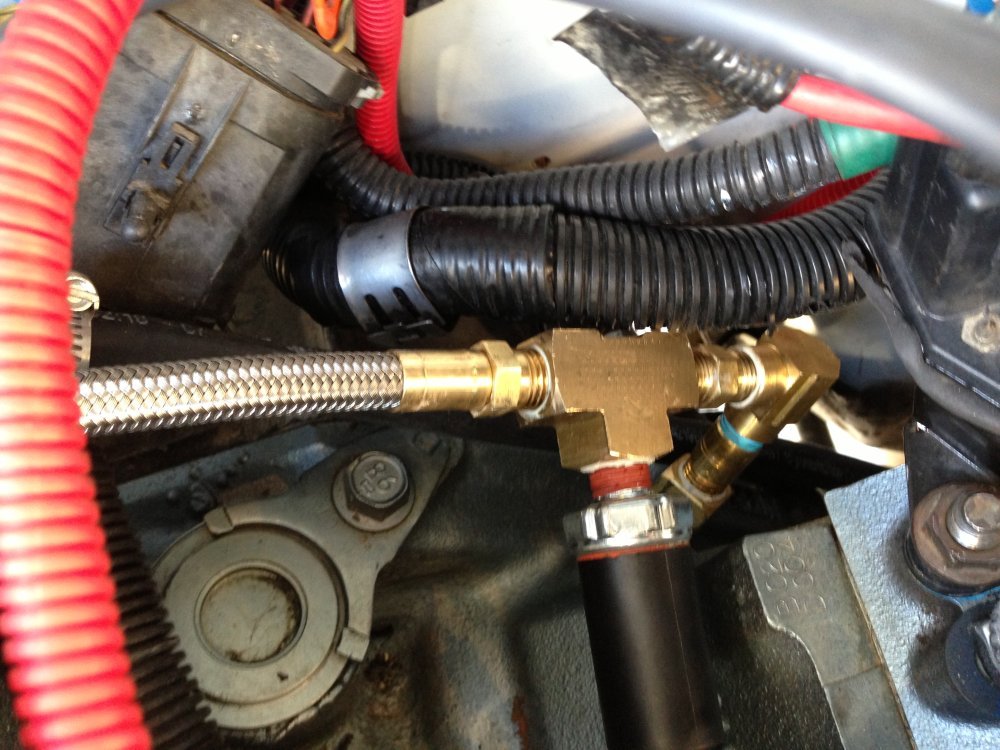

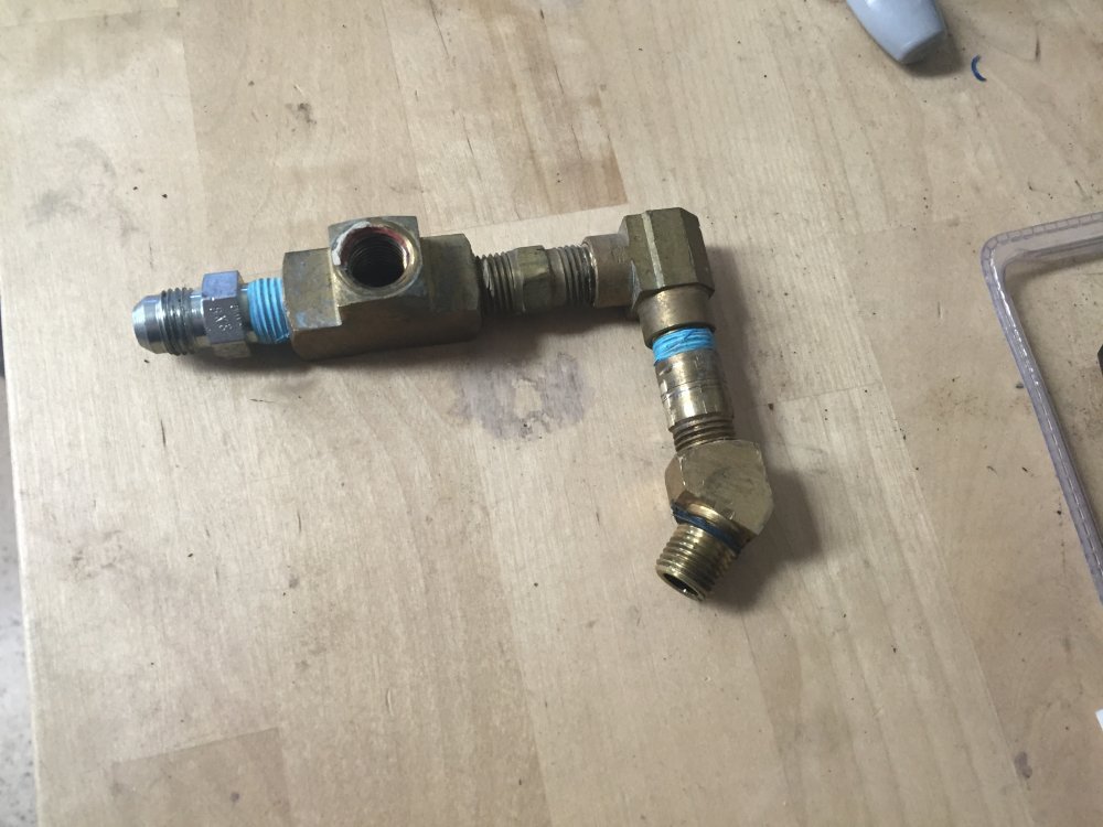

Turbo & OPS Oil Feed ports: You will need to pay attention to the turbo oil feed port on the front of the block because chances are your donor block won't have one. There may not be an OPS port cast in the valley either. On my block, is a port at the back of the motor, driver's side. I cobbled up brass fittings (1/4"NPT) to a 'T' block to accommodate both OPS and Turbo Oil Feeds. If you have to go this route, do it before you drop the motor in, Pretty tight working area back there along with back strain. Trust me.

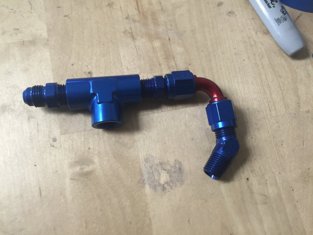

Don't get fancy, use brass. I tried to 'upgrade' to ARP anodized blingy stuff and there's no path to ground for the OPS.
