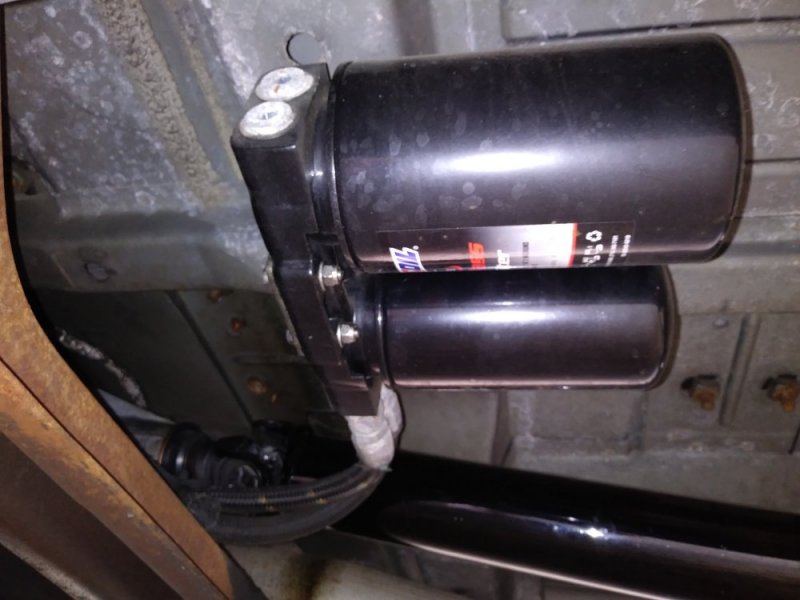

I went the easy route and used Amsoil's remote kit which uses the oil filter port on the block. For the 6.5, there is an additional adapter necessary which is not on their web page as part of one of the kits. And, depending on the mounting location, might need to purchase an additional section of hose. End result is that I have two easily accessible filters (primary and bypass) in one location which make changes *much* better than the OE 4WD setup.

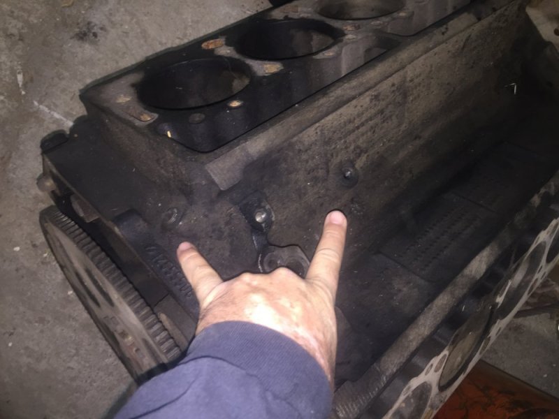

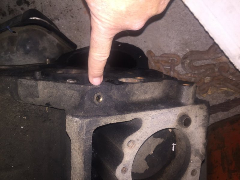

Picture pointing with 1 finger is front of block passanger side just lower than head is end of the line where pickups get turbo oil.
Picture with index pointing at rear location opposite -Rear driver side below head. N/A hummers use this as oil pressure sensor location. Pinky finger pointing at valley port where pickups and most hummers and vans install oil pressure sensor.

Im kind of liking the idea of the amsoil kit. . . . now i just need to figure out if i have the space.
There is plenty of space under the truck.

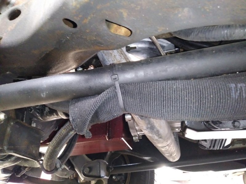

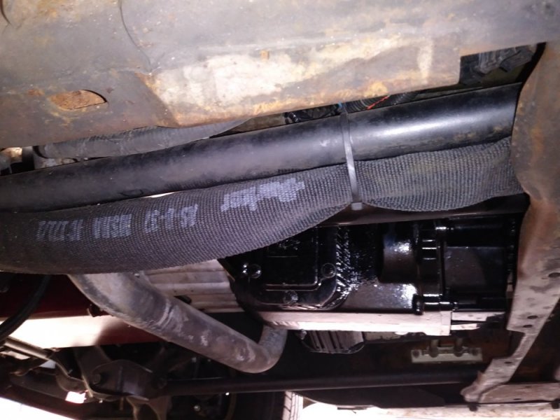

Mine was mounted horizontally under the cab. Well, actually, aft the firewall the Burb is all cab, so for better clarity, the filters are under the driver's seat. I had to buy an extra section of hose as the one that came in the kit turned into just the supply line instead of cutting it and turning it into the supply and return. The nice guy at Parker who made the return hose also talked me into a mesh sheath to run the hoses through so that they would not chafe.
Will get pictures shortly as the truck is at the 'doctors' getting some love at the moment.
