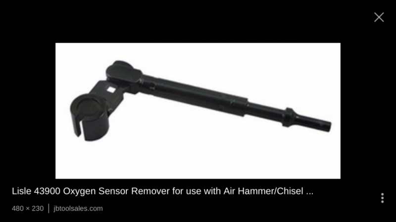

We dont have rusting problems here in Southern Nevada. But I dont know a single pro mechanic (technician as some prefer) that doesn’t own the airhammer drive tool for O2 sensors. That “expert” needs to invest in his profession. Does he own a screwdriver or is he still using his moms butter knife?
Quick pic of google search for those that never seen them. Cheapy sets are ok, any pro should have Mac, Snapon, etc.
Never seen nor heard of one of those before.
