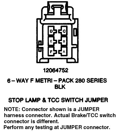

The 95+ trucks use a COMPLETELY different switch than 94- trucks did. It is NOT adjusteable as it simply goes over the brake pedal pivot point and is spring loaded. It takes about 2-3 pounds of pedal pressure to push the spring in the switch and make contact inside the brake pedal switch. The brake pedal switch is a 3 part switch with 3 SEPERATE sets of contacts inside of it. You have one set of normally closed contacts in it for the shift interlock solenoid(the switch that prevents you from shifting until you depress the brake pedal). It powers the soelnoid preventing it from allowing the shift cable to move, but once you depress the brake pedal it cuts power to it. Next you have a set of normally closed points which sends power to the ECM when the brakes are not pressed. Then you have a set of of normally open points that are powered when the pedal is depressed. This set of points is the ones that actually turn on the brake lights, but it also sends a signal to the ABS and ECM. EITHER set of ECM feeds can cut the cruise control as it is a double fail safe system. Also the power to the normally open set of points that powers the brake lights also powers the turn signals, so if they're working the brake switch should have power to it. And don't automatically assume the switch is faulty because you have no brake lights. Not sure if your truck has the 3rd center high mount brake light, but the brake/turn signal lights run ALL power through the multifunction turn signal switch. So if theres a problem in your turn signal switch, you can lose brake lights. Give me some time, and I'll find the wiring diagrams for the brake switch and post em up.
From what I can find(all I have is my 95's diagrams, so the wire colors may be different from OBD1 to OBD2, but they are both the same body style so should be very similiar as far as wiring goes), the orange wire to the brake switch is the power feed from the fuse panel for the stop lamps, and the white wire is the wire that should carry the brake light's power from the switch. This wire goes to the turn signal switch, and it sends the current back to the rear tail lights. If you have a center high mount stop lamp(3rd brake light), it will be powered off of a splice in the white wire BEFORE it goes to the turn signal switch.
This is a picture of the brake light jumper harness connector. Theres about a 6 inch or so long harness that plugs into the actual switch, and this is the connector that hooks to the body harness. It is reccomended to do all testing at this connector instead of the actual brake light switch. From what I can find, this is what each wire should be. I'm not putting which cavity each should be as there is conflicting info as to which is which for the C, D, E, and F, but A and B seem to be for the brake lights in everything I can find.
orange is 15 amp power supply for brake lights
white is brake light power out of switch to truck. Goes to a splice point where it branches off to turn signal switch, ECM, ABS, and 3rd brake light
purple is the ECM feed for the normally closed side
brown is the power for the normally closed ecm feed
green is power to the switch for the shift interlock solenoid
green white stripe is power to the shift interlock solenoid
