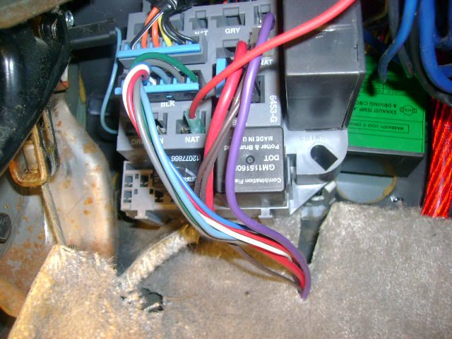

Brake control mounts in cab and gets brake signal from a terminal on the in cab fuse/relay center
Can anyone help me out on finding the correct place or wire to tap into for the brake light switch?
All the other wires have been a piece of cake. But I am having a heck of a time finding the correct place to connect to the brake signal.
Thanks!!!
I take it this is on your 96?
If so, there is a pin, cant remember which one, but it was on a lower row of the under dash electrical center. I just took a test light, touched them all, took note of the dead ones, then put one hand on the brake pedal and re-checked the dead ones. one should light up. this is the right pin. I just used a crip on female spade end and tightened the one side of the female part a little more, then slid it over that pin.
And there you go, clear as mud probably, but that is the no-splice way of doing it on the 95 and up dash.
Good luck!
Excellent, I will give that a shot tomorrow. That coincides with what TD was saying as well.
And yes it is for the 96-99 newer dashes. I am doing both trucks at once :)
Thanks!
Here is what I ended up doing... Please let me know if this is a bad idea. :)
Looks good to me, How well does it work?
I did something similar on a ground in my truck.
Now I know what that wire hanging out of mine is for! My brake controller! THanks!

Thanks for the + feedback on saying it is a good spot. :)
NAT = ???
If you look at the top row on the fuse panel there is another slot that says NAT as well, but I did not check that location with the DMM.
