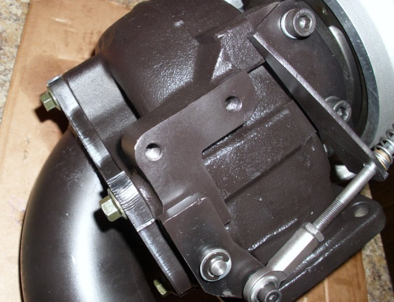

HX40 clocked for CAC 001.JPG There are 2 machined holes at top of turbine housing one of which I could run a custom brace up and over to the center intake mount of old brace.

As the GM8 has 2 braces one at compressor outlet which is commonly removed showing no ill effects however the other runs from top center of intake to top of turbine housing and I some concern over that one. Everything I read about the turbine brace is related to supporting/distribute the weight of the turbo so input from those who don't use braces is a good indicator for the yes/no factor.
