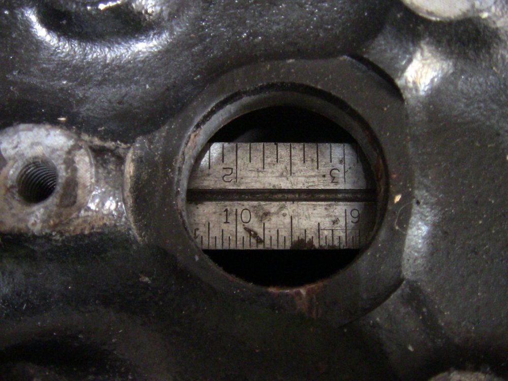

Doubtful, there is 6 1/2" from top of the deck to the bottom of the coolant passage. the bottom of the freeze plug is
1 1/2" from the bottom, the top is about 3 1/4" from the bottom, the highest point that can be filled is the bottom water pump bolt location, so my short fill is 3 1/2" up from the bottom that is more than half of the actual cylinder length.
And the bottom of the block is thin in stock form. It's fielders choice....
