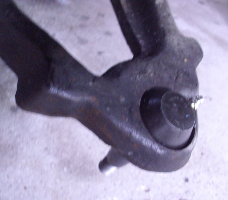

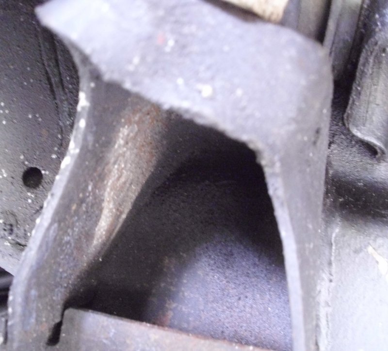

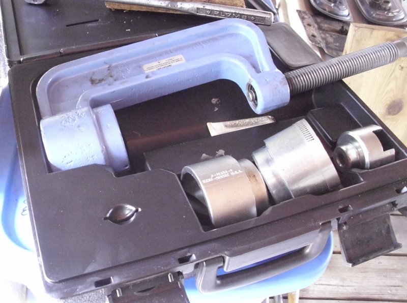

Well I finally got back to working on the 99 Burb replacing upper/lower ball joints w/MOOG problem solvers, d/s half shaft and inner hub seals. I found the d/s upper control arm stop bent down about 1" so will fix that too using porta power w/clam-shell tool to spread it back in place. J-tool makes easy work of removal and install of lower joints especially if the joints are left in the freezer for a few hours.DSCI0010.JPG DSCI0012.JPG DSCI0015.JPG
