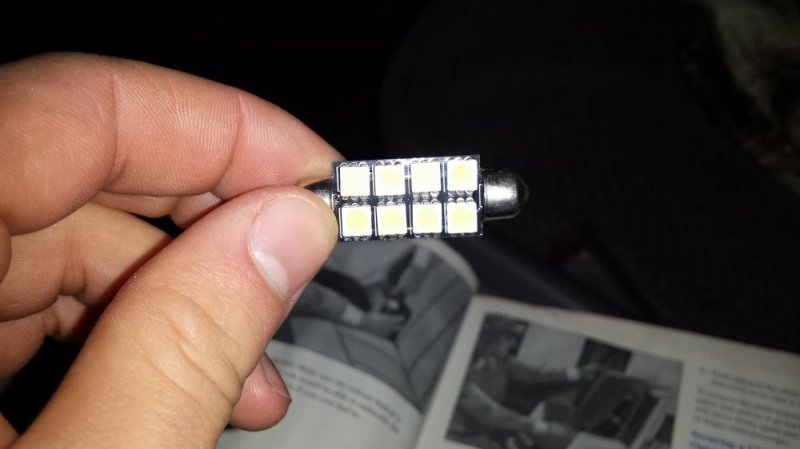

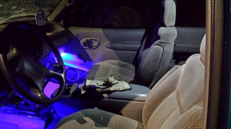

I bought a bag of 20 or so 194 LEDs for $9CAD from Amazon. They have been in the dash for a couple months now, no issues. I have a LED dome light as well, the cool 6500K colour takes some getting used to. I'll try and take a picture tonight. Can't really comment on the can-buss system, I think they are the same wattage as a 194 you just get more light output. I had some more expensive 194s in the dash prior to the amazon ones, but the chips came loose after a while and they began to flicker.
