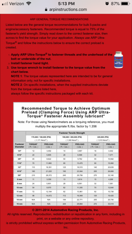

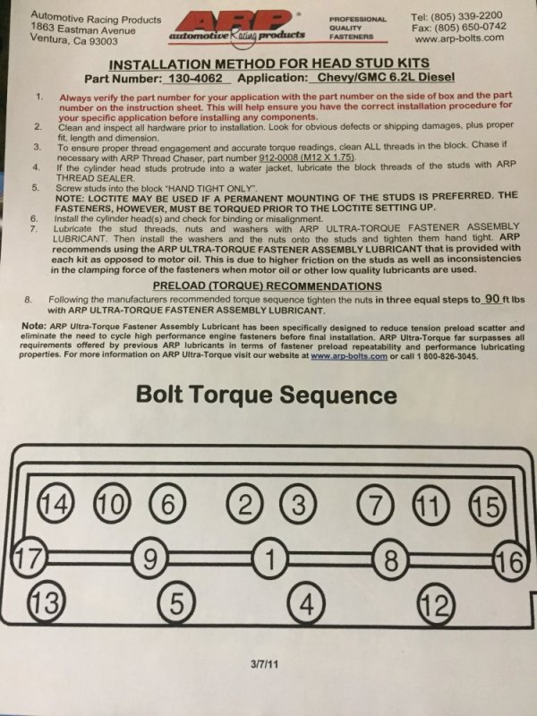

ARP has a generic torque chart (see pic) but it you notice- ARP calls for 90 on the head studs. (Too much torque causes issues long term). But look at the possible loads the stud can handle. WAY more than the heads can handle.
Infact, I used it when I made my homemade studs for the i take manifold adapting van intake to truck block. Got no where near close to minimum and DESTROYED the gasket and cracked the first intake I had. So lessons of the past relearned.
I dont want “well I used X and it is still running good”. I could guess myself and just buy one-sy two-sy and saved a lot trying the learning game.

The headstud instruction sheet is example of what all their sheets look like, and also to show the torque ARP says vs the generic sheet.32F96E52-8AD0-43E9-9059-9DEBEC77495F.jpeg

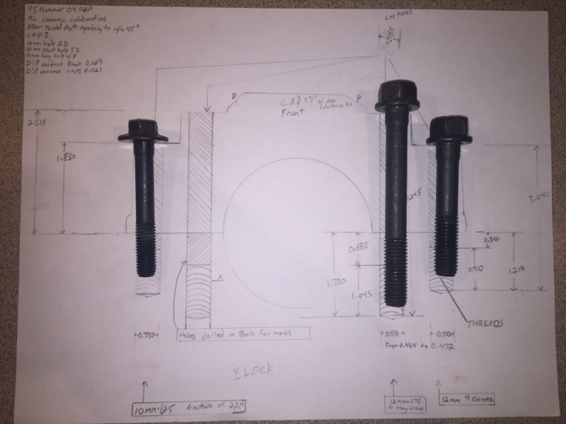

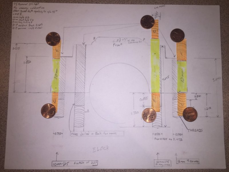

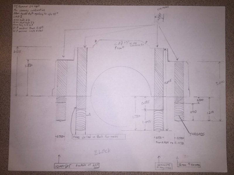

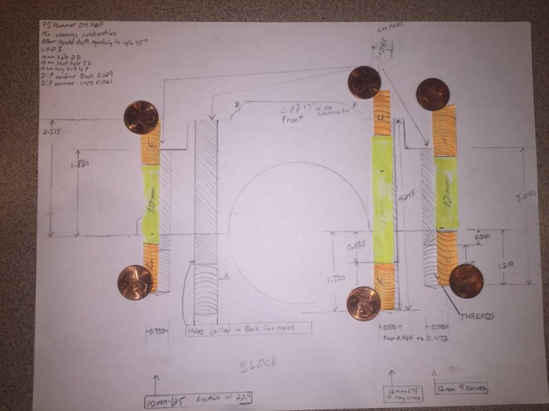

For me to find (and describe) the issue, I did some measured drawings. DO NOT ASSUME YOUR ENGINE IS IDENTICAL!!!
The colored cut out “studs” in the pics show a good example hopefully without giving away info for anyone to undercut John’s investment. The only spec on the stud I will post here is the outside diameter range given to me over the phone by ARP. I didn’t measure it when I had them. John’s kit should work ok for most engines- just know what to look for and use your judgment on spec, procedure, fitment.
More to come within the hour...
Just realized Quickest answers / issues should have been first.
DO NOT LET THE SHOULDER OR SHANK OF THE STUD CONTACT THE BLOCK.
DO NOT LET THE BOTTOM OF THE STUD CONTACT THE BLOCK. ALL THE WAY IN, UNSCREW 1/8 - 1/4 TURNOUT. NEVER APPLY ANY TORQUE OF STUD INTO BLOCK FOR MAINS UNLESS IN FULLY CUSTOM STUDS ARE DESIGNED FOR IT. Many copy this being done in race engines like top fuelers. The bottom of the hole in block and stud are both made special for this. These studs will sideload from it. ALSO IT WILL AMPLIFY VIBRATION TO THE MAIN WEB, which is a major issue for us. If any loctite is used, final nut torque must be achieved before set up time, no disturbance afterwards. If you do not use loctite or similar, you MUST use ARP lube on the threads. DO NOT use these studs dry since we have soft bottom ends per ARP.
According to multiple ARP guys, any of these rules broken may be worse than just using stock bolts. The rest is subjective to situation, these are in concrete.
pic 1 is MY block with main cap on it.
Pic 2 is MY block with main stud kit in it.
pic 3 is the theoretical perfect block with main stud kit in it—with exception of bored holes, explained later
pic 4 is my block with factory bolts in it

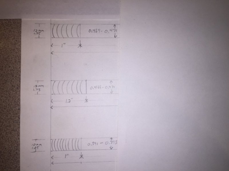

pic 5 studs from kit showing diameter of shank, depth of thread to shank.
Look closely at how high the studs sit in my block. The shoulder is hitting a the block face on some and a hair under block face on others.
The problem is the hole that is drilled in the block before threading. Note the dimension range I show. Note the hole dimensions of the cap holes. Some blocks have the block hole above threads even slightly larger than the hole in the cap. If your engine has the larger hole so the stud never touches it- BOB’s your uncle! Run them happily. Just determine your final torques first and work your way from there.

Ok, how many threads is something that comes up.
ASE, ARP, Moroso, etc all say minimum is 7 threads on bolts or studs for full strength. You may have more threads in contact, but in most cases only 7 does any good.
Getting the studs to the bottom of the hole means approx 13 in contact, the bolts drop out after 11, studs benefit all the way to 18, but first 12 hold 95 percent- and this requires thread filler (thread locker, silicone, etc) to get any benefit above 10. Now this is one of the critical ellects of the bottom of the stud NOT torquing into the block. The lateral pretension of the stud eliminates any chance of the extra threads carrying the 2-3% that they may carry. Mind you anything above the 7 is very dependent upon the female threads being cut perfectly.
Not everyone agrees to the advantages of any threads beyond 7. And the 7 is a rule of thumb, it actually changes based on diameter, thread pitch, thread fit, etc.
