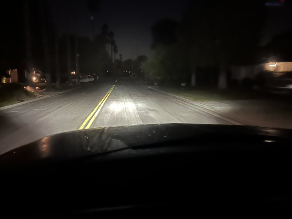

Are my headlights too bright
I wouldn't say too bright but it seems that they are lighting up more of the other lane than the shoulder on the right. maybe pivot them over to the right side just a tad. it looks like they both are focused more at the drivers side of the lane in the same spot. I would focus the drivers side to more of the middle of the lane and the passengers side a little further on the right side. that should give you a wide range and still cover the area you want. but that's just me.
as for blinding on-coming cars, their not focused in the other lane, maybe get someone to drive past you in a smaller car and see what they say?
I was working hard to get the driver’s side over to the left and ran out of adjustment. Had not spent much effort on passenger side, but see what you are saying. Some of this is impacted by the sagging grill which will be replaced.

Definitely not in adjustment properly.
Flat ground, 25’ away from a wall perpendicular. Measure from ground to center of the headlight.
The top of the light line should be 3” below that measurement.
Foglights if you run them should be 3” below their height, again at 25’ away.
Both headlights and foglights should point straight forward.
On lower passenger cars the rule is 2” lower not 3”.

It’s weird because when I drive it, I feel like the driver’s side headlight needs to move more to the left. Also feel like the bulb in the passenger side is not as bright or the bulb needs to be rotated. Either way, the concentrated part of the beans needs to be further apart.
I will do the Will L tale of the tape measurement tonight. Have a very slight downward incline to the driver before the garage. Guess I could put a level on the roof and place boards under the front tires until level. Won’t be more than a sheet or two of plywood.

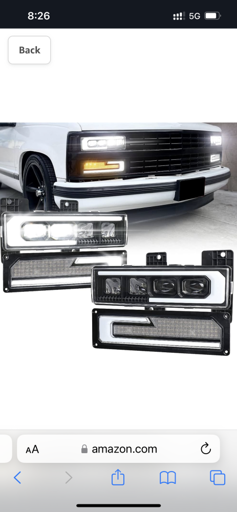

They do have LED housings for the GMT 400, but they are pricey:
MOVOTOR LED Headlight Assembly Replacement 500% Bright Anti-glare Headlights with Welcome DRL Turn Signal Lights Compatible with 1988-1998 Chevy GMC C/K 1500 2500 3500 Suburban Silverado Tahoe Yukon
https://a.co/d/bEHRAtn
