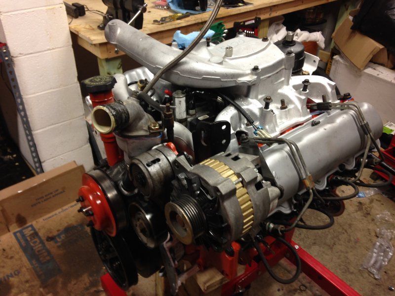

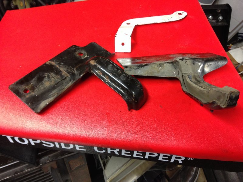

I am almost done putting the engine back together, but I need some help with these last few brackets on where they go. The first pic is of where I am at with the engine and the second pics are of the brackets. Can someone tell me where they go. This is my first time rebuilding an engine and I know now to take more detailed pics than I did.

The silver one is the starter heat shield. The black one looks like a radiator support. The white one I don't recognize.

right pic are upper rad supports, the white one looks like it bolts to the back side of the drivers side head. I tried to upload a pic but it wasn't happening. On the small 90* bent piece there is a plastic split grommet that holds the engine harness.
Yeah upper radiator hold downs, and white one looks just to be a wire harness support?? looks like it bolts to head as Leo said.
Ha! took another look and the silver one isn't silver at all. that's what I get from using my small phone screen
