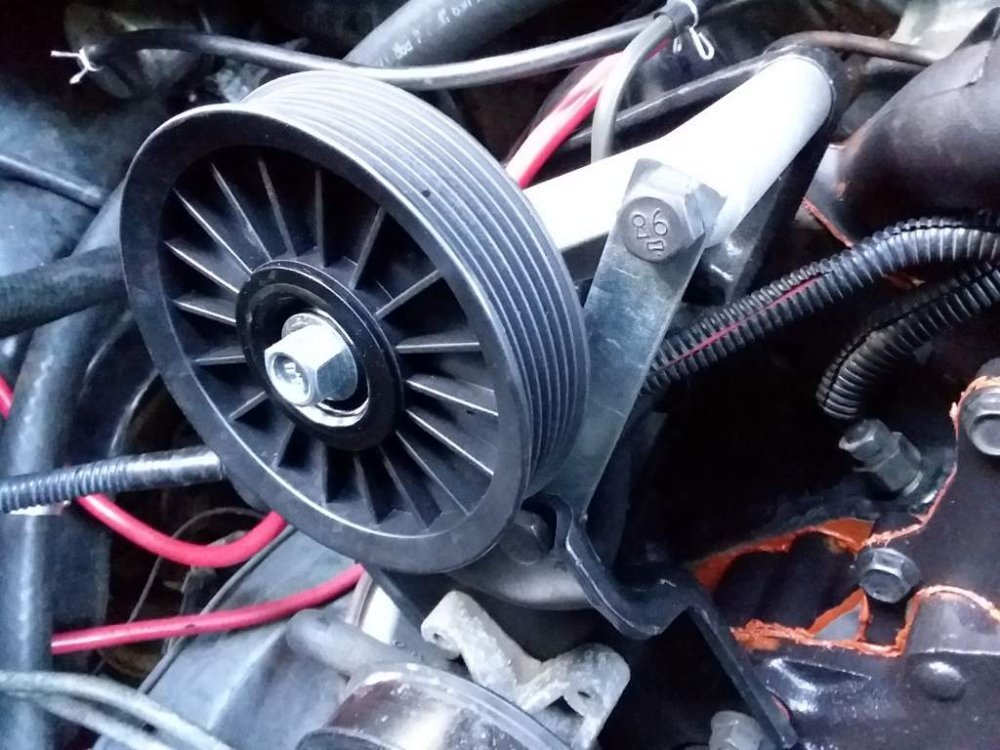

6.5L AC delete pulley
there is also this one I found over on DP where they show a pic of it installed. I'll re-post that pic from that page and the dorman link
Here is where I got the info from.
I've read none really fit right.... might be just as easy to use a compressor....
I got one of those 3 bolt flange ones from Rock auto for the 1988 Buick Century. Only two of the holes would align. After maybe 30 to 50 miles it busted off one of the brackets bolt holes.
I then just got the pulley/bearing to mount onto the old compressor and it has been idlering along just fine ever s
