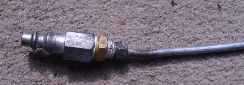

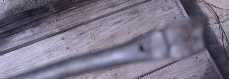

I made a blower tube for blowing out the leaves and dirt, took and air fitting and soldered a 20" straight metal brake line crimped the far end and drilled some very small holes down near end all facing the same direction , its small enough to slide between the different components in the cooling stack so you can blow everything from behind and out towards the front 'works great.'
Pics? Just wondering how many holes, what size.
The hole on this one is 1/16th, I bent the tube just after the air fitting so I know which way the air is being directed. Used this method many times even after bring in some sand storms out in AZ it blows out all the sand, bugs and other things that clog the fins.... DSCI0025 (1).JPG DSCI0028.JPG
