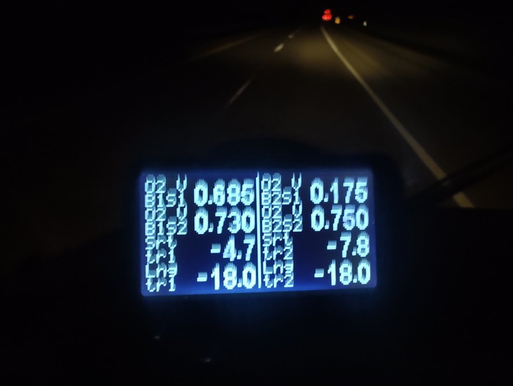

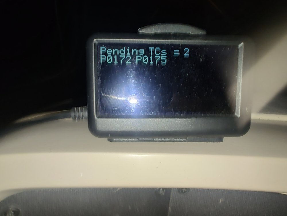

pictures show my odb ultragauge mx while troubleshooting the new and faulty MAF

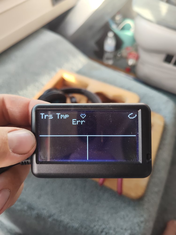

i don't see anything from ABS or Transmission on either my Innova 5210 from O'Reilly or my UltraGauge MX 1.3

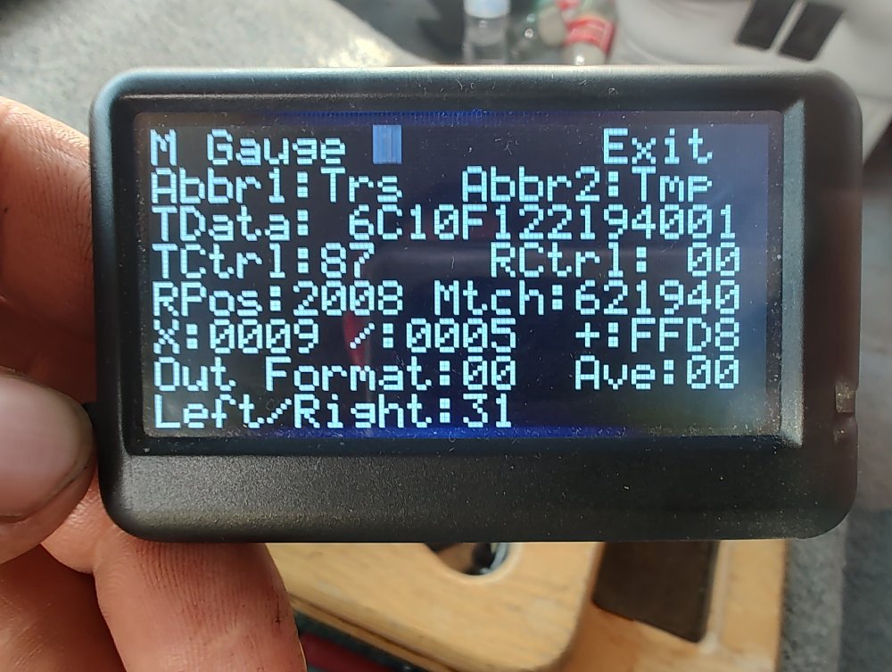

i found someone who translated scangauge to UltraGauge for me, but the details we've found was for Allison transmissions, not the 4L80E and the results are disappointing
also tried Tctrl 86, same result
hence my question for a shop around Seattle who could actually hook up to my PCM and see what's it actually commanding and what fault codes get set

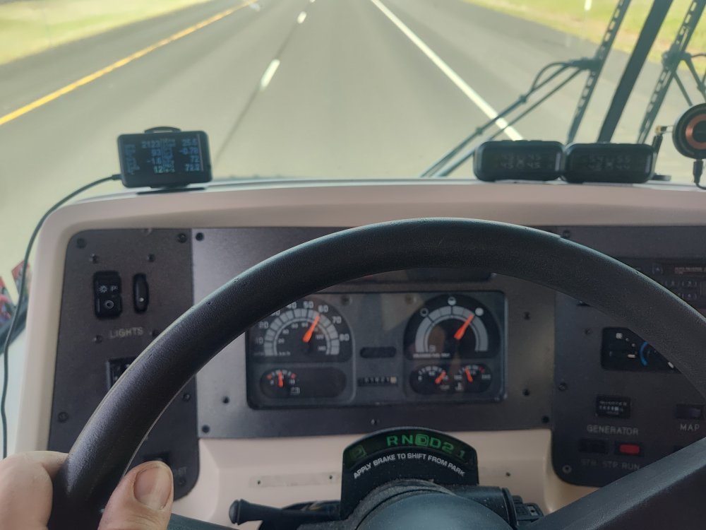

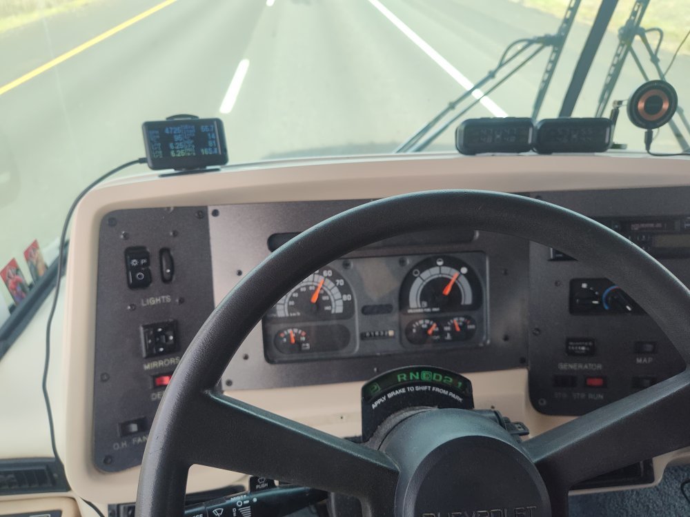

one picture doing fine in OD 4th and the other later on with the engine in the limiter at 5k rpm and the gear selector still in OD 4th..i hope you can read anything on my obd monitor... not easy to take these pictures...

second part not so much, limp means all shift solenoids off and from my understanding thats a hard 2nd gear, but thats not what its doing, its actually neutraling... not going to 2nd.
Sometimes it opens lockup
sometimes it goes to 3rd
sometimes it goes to neutral.
it never gies to second or first while at hwy speed
selector always in od 4th
since today it start doing the tc lockup kick out in 3rd too... but rarely

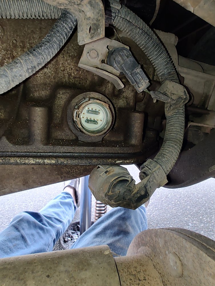

but i pulled the plugs on the gear selector modul, they are flooded with dielectric grease, looks like my prepre owner had that issue already, he bought it new and stoped using it due to health in 04 an died soon there after. since that 2004 until i bought it in 24 it made leas tham 100 miles. 87 i think. it got sold across the small town that was its home base and then doing office duties with the second owner only, i think he literally only drove it to inspection into town 4 miles round trip or such.
oh, and don't have a MH on stilts, key on accessories on and then pull the gear selector plug while under it on a dolly... it'll decent right onto you... I've just learned that the hard way and barely got that darn plug over the hot exhaust back on.
took a while for the adrenaline rush to die away
