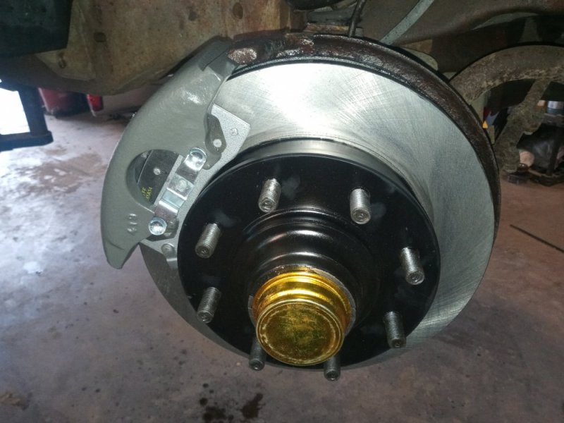

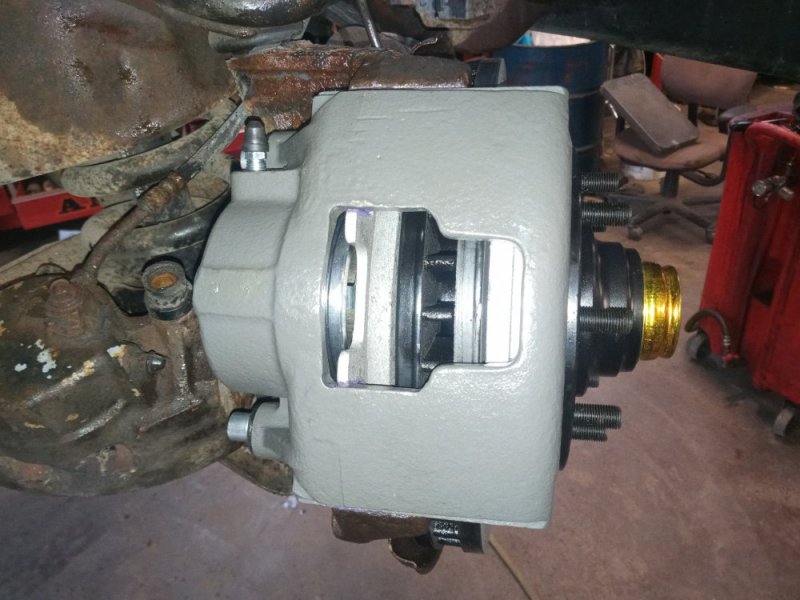

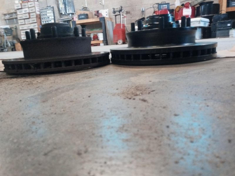

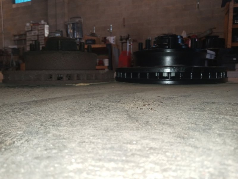

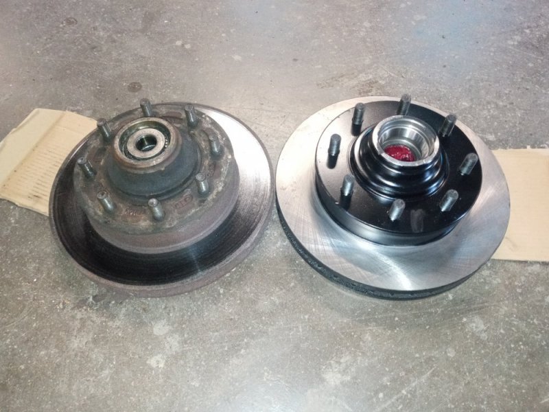

The upgrade to the thicker front rotors from the 2002 Chevy express 3500 installed on the 95 Chevy suburban C2500 7.4 was a success. The rotors are about a 1/4 inch thicker and the calipers that match and fit the rotors have 3.250 diameter piston and my stock suburban had 3.000 inch diameter pistons. The pedal feels great even with the larger piston. This suburban does have the hydroboost from factory. I believe this upgrade is much like they do with the 4 wheel drive suburbans but I had to track down a 1 piece hub/rotor with the 39.1mm thickness for it to work on a 2 wheel drive.
