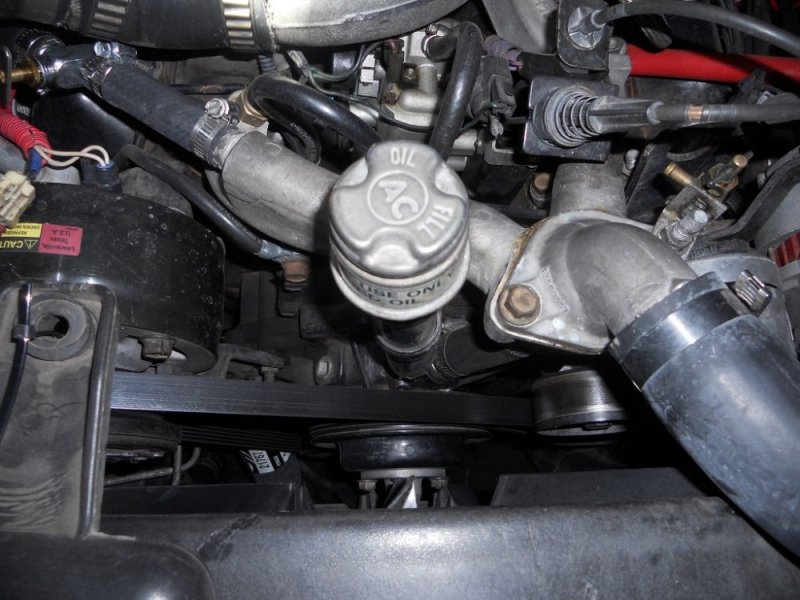

It's possible the 6.2 caps open for excess vacuum, but, I doubt it. They are huge as this 1985 example 6.2 cap here. IMO the huge is used to reduce the oil vapor mess.
