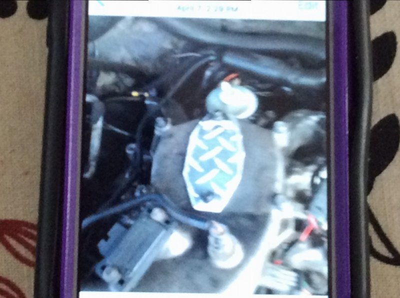

image.jpg Thanx I'm exploring lots of avenues and relocated pmd to fender wall where abs was removed for pro portioning block and harder to start now so looking at lift pump andops going to put in new glow plug relay as I have an extra one pmd was replaced when relocated just like life a learning curve oh also removed EGR and put a plate on intake plugged vacuum lines

@Pickseed did you install F code gaskets or preferably a F code lower intake when you did an EGR delete? if not, it will puke exhaust into the intake.
Also, get the PMD out of the engine compartment. Intake, fender, firewall, they all suck. Put it in the grille or bumper.
