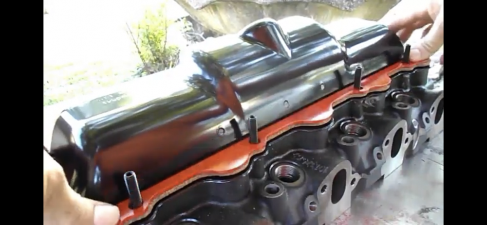

Also Leroy @Burning oil of Leroydiesel.com came up with a “valve cover girdle & stud kit” that is one piece of steel that you paint or powdercoat yourself to match your look. I can’t see them on his website but here is a pic and a video showing him doing install.

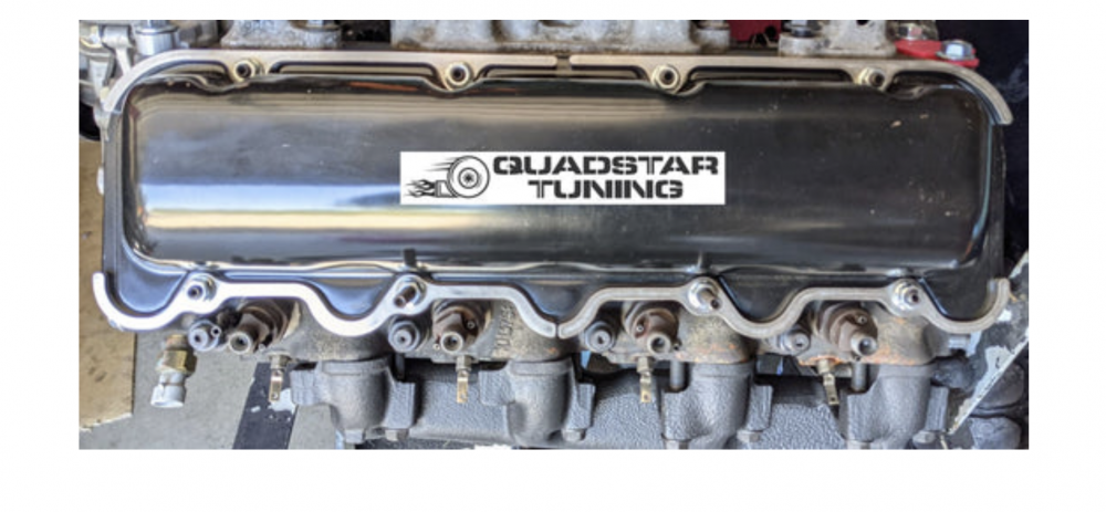

And here is a picture and link to @quadstar87 Quadstartuning.com who made a 3 piece unit of stainless steel and studs.

I was on Quadstar Tuning the other day and I seen the stud and girdle kits in there. Looked impressive to Me.
I would also like to see what @Burning oil Leroys set looks like too.
A couple of pics would be nice.
After watching the videos.
If a person will be using Leroys valve cover gaskets between the head and the valve cover, then, they would need to order two sets of valve cover gaskets in order to have enough gaskets to seal in the oil and also another set to lift the girdle so that it properly pinched the balve covers in the narrow areas.
If just using RTV sealant to hold in the oil, then a set of gaskets would need to be ordered to give the girdle the proper pinch on the cover.
At least thats the way I seed it in the vodeo.
@Burning oil maybe You could clarify My information.
