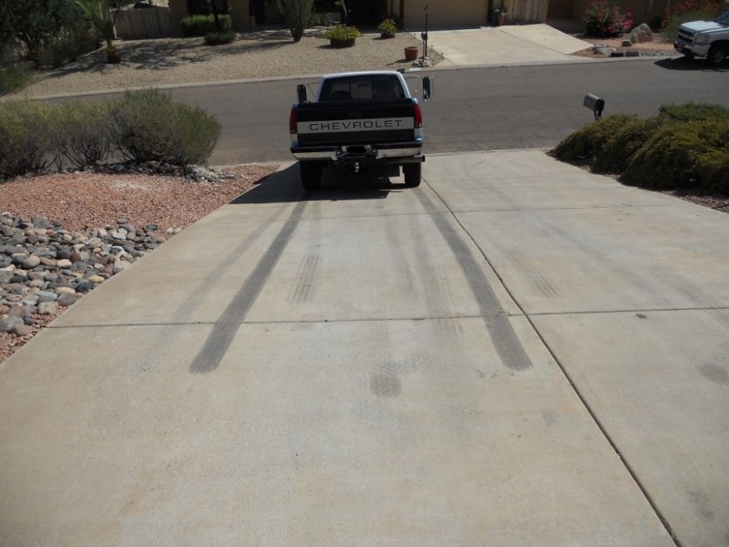

I just don't get enough traction in my driveway with the parking brake backed in. Seriously my truck does a burn out with the engine OFF!

Wow. That's crazy. What's the grade on that thing?

Are you sure someone didn't pull it down the drive?
Yes. The Cummins already did this a small amount and I figured it was just the weight of the engine out front on it. New tires on patch and this is the first time it has done this. The grade is extreme on the driveway - you have to get a run at it or you spin out in reverse.

Sigh! Monthly tire pressure check shows part of the problem. No edge wear on the rear tires. Rear PSI is 70. :facepalm: I told the shop 55 front and 50 rear... So less rubber patch on the road for traction with high PSI and unloaded bed.
