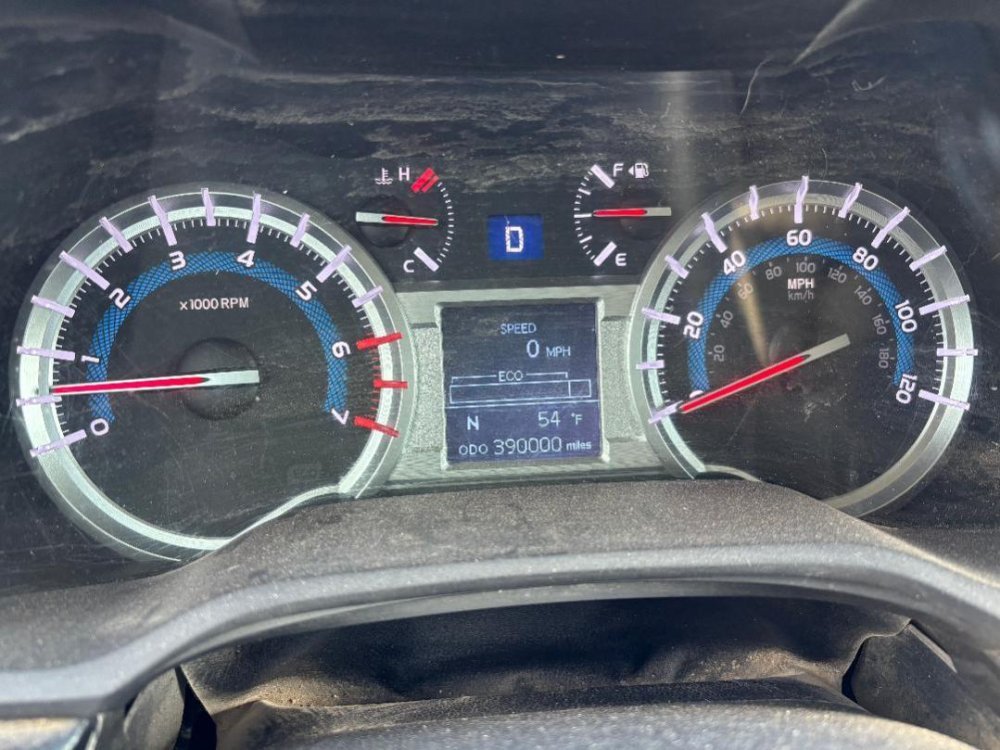

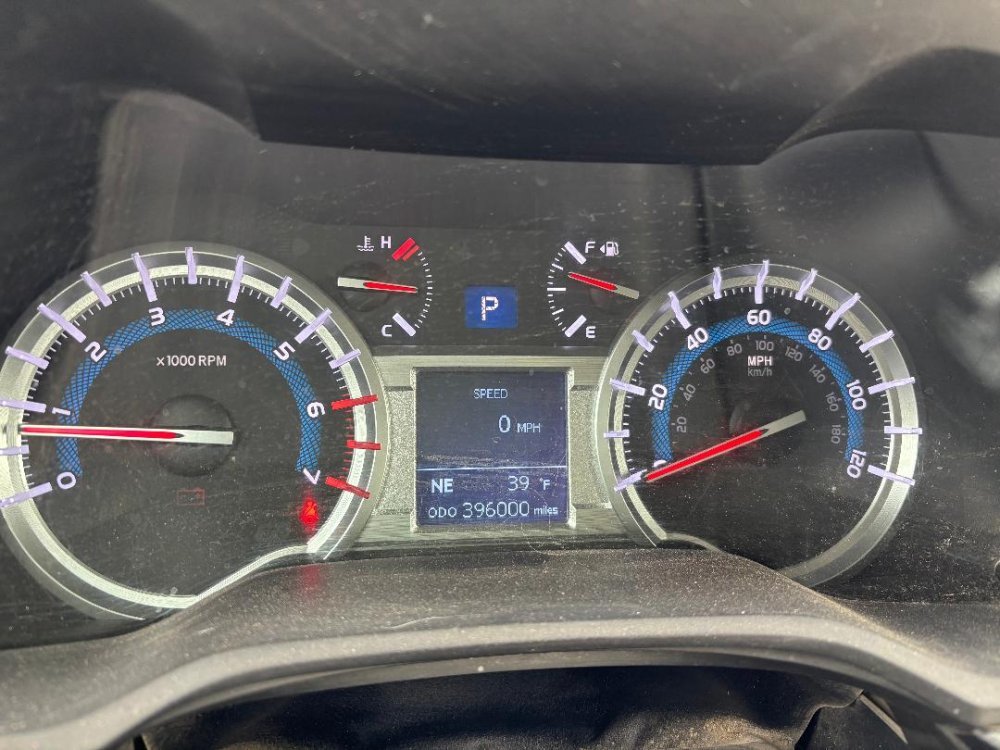

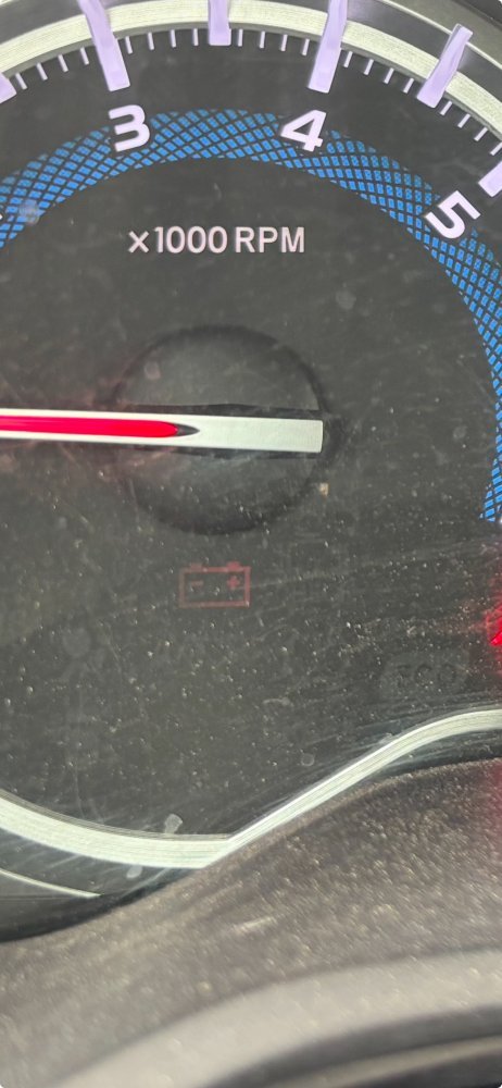

Alternator went out on the 2014 4Runner, stranding my wife in Mackay, Idaho (population ~500). Original alternator went 318.5K miles. I replaced with new Toyota Denso alternator and that lasted to 395.7K miles, or about 78K miles. Replacement alternator (do not know if it was new or reman, but it was $332) arrived late Monday and the local mechanic it in and sent her on her way. She made it to our Montana home late Monday night, with no further issues. However the battery charging system light remains feintly lit as shown in the following before and after pictures:
What could be causing this?
I use these cigarette lighter volt meters
Update: Discussed the feint charge light and the sporadic no-start with my local mechanic on our loop road (he’s very good and wants to hire me when I retire, but I will only work on my cars). He said the no-start pointed towards issue with the starter. So I ordered new Denso Starter and Alternator from dealer while they still had their sale going on and free shipping.
I had to return to work in SoCal, so I left the parts with my wife who took the 4Runner into the local mechanic. I also provided a list of things I wanted him to check while he had it up on the lift.
Starter had a corroded cable and a broken bolt. The corroded cable was the likely cause of the feint charge light and the sporadic no-starts. With both the new starter and alternator in, the charge light is now officially OFF!
