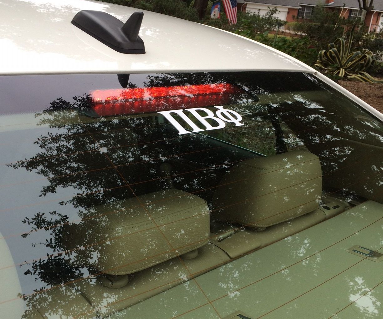

Hello all,
My son's 2006 Jetta TDI has an issue with the third brake light mounted up in the back of the head liner. it apparently hasn't been working and we did not know it until recently. he's gotten pulled over twice now both let off with a warning, but it was for the third brake light not working.
I pulled the cover and the light thinking it was a bulb, but come to find out it has an LED strip in there. So I did the wrong thing and probed 12v power to the two pins on the light assembly. it lit up and worked, but when you connect it to the car it does not work.
My daughter and her husband needed to borrow the car the other day and he said he played with it and got it to intermittently work, but said the connector and the wires that he could see going into the headliner seemed fine. I also looked at it my self and verified the wires looked perfectly fine. there is no indicator on the dash like there would be if a bulb was out and I also used the vag-com to scan the car and it came up with nothing.
since my son has gotten stopped twice here in our home town I am sure the next time will be a ticket. I need to figure this out before that happens!

Well it's fixed! I used the laptop and did the output function tests for the brake lights while I was sitting in the back seat. probed the wires and was getting 12v at the connector!
pulled the light out and took it inside. used the link @ak diesel driver posted about repairing the LED strip. when I pulled it apart I found one of the pins had a loose solder joint. fixed that but it still didn't work.... but... as I was holding the strip board in my hand all of a sudden the LED's began to glow dimly as I slightly tweaked the board in my hands it got brighter.
pulled it back out and went back to my soldering iron. I reflowed the joints on each resistor and the diode on the board hoping that none of the issues were on the LED's them selves. tried it again and it works and is bright!!
put everything back together and re=attached it into the car, tested the brake lights with the pedal and everything works! YAY! My son is happy now he's not gonna get a ticket for that at least.
