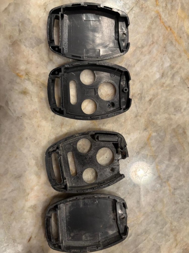

Top = New key fob case. Bottom = old broken key fob case. New will crank the engine, but no start. Other set of keys with old key fob will crank and start the vehicle. At the top right of old broken fob there is a rectangular piece, is that for sending a security signal to start the vehicle?
I was unable to remove that rectangle from the old fob and the new fob has nothing to hold it. Sounds like I need to pull that rectangle and transfer it to a new fob with a holder for it. Can anyone help and confirm what I have going on here.
If You got plenty of room then try gluing that rectangular piece into the non busticated fob, put it together and see how it does.
Or even a little tape to hold it in place temporarily.
I cut a strip from an ad card in the mail. Folded it in a size and thickness that would mop up the space and make it a snug fit. Essentiallly, I fabricated a shim to firmly hold it in place. I then put it back together and my tests had it working just fine. So it’s good now.

Can’t believe I failed to transfer the RFID chip in the first place. But it was snuggly in its old receptacle and I was working with tired eyes. I just assumed it was a fixed part of the old case. Now I’m feeling pretty stupid over this.
I was just gonna say to take the old case with the thingy in it and hold it near where you insert the key and see if she fires up. if so and your not concerned about the RFID chip. you can trim it out and then hide it inside the column under the plastic shroud. with that in place you can have any old spare key cut to turn the cylinder and will start the car.
