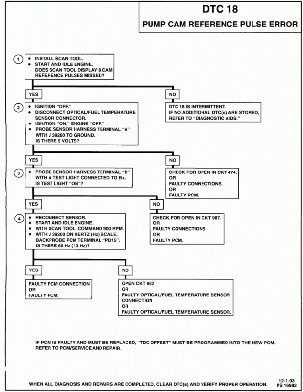

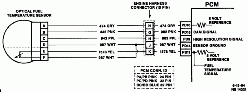

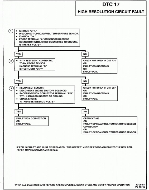

Heres some reading for you. These are the diag flow charts, they're just for obd1 so the code numbers are different.56534565.gif 56534564.gif 56541661.gif
