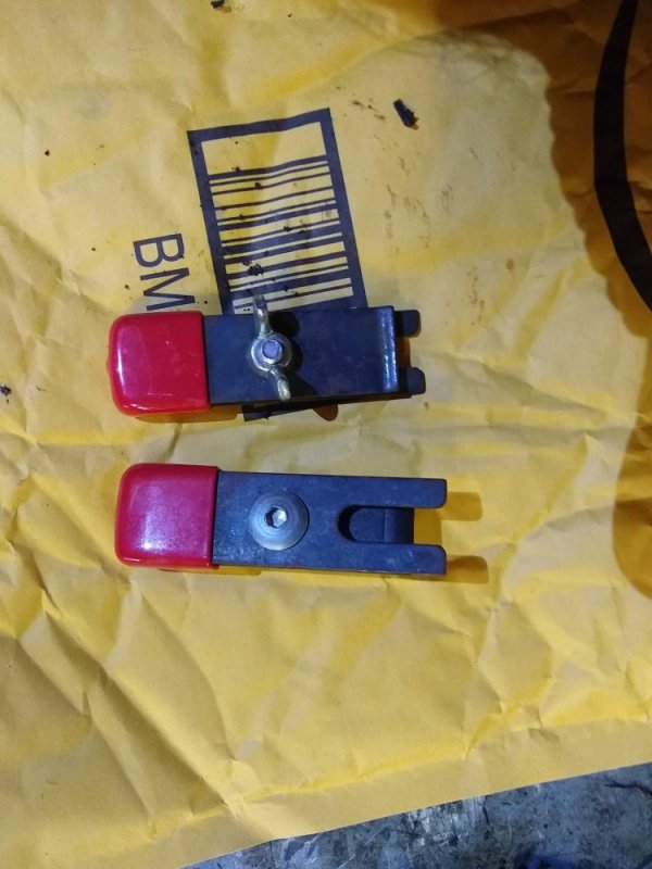

DO NOT PUSH IN ON THE VALVE LIKE THAT YOUTUBE VIDEO! Those are NOT bleeders, those are the valves in your proportioning/combination valve that is no longer being produced or available for sale, so if you damage it you're SOL. The video showing the plastic tool for bleeding does not apply to the 95 abs, you need to depressors to install over the proportioning valve to lock it in the center for bleeding. And you really need a tech2 to bleed the brakes. Otherwise you will need a dirt/gravel road to lock the brakes up on to get the abs to kick in to move the air out of the abs assembly. But this involves getting enough brakes to be able to lock them up. Once you get air into the abs system, you cannot get any sort of brakes until you get the air out.
These are the tools for bleeding the 95-02 abs system. You can also remove the rubber covers and put a C clamp over them.
I have seen those tools before. Didnt not know whut they wuz fuhr.
Now I do.
I have never needed any of those, of course, this is the first truck I have owned that was newer than a 94. 🤷‍♂️😵‍💫😹😹😹
My question is where do you buy them?
I bought them YEARS ago off of ebay from a wholesale closeout sale. Not sure if you can still find them or not.
Found a place that shows to have 25 of them, kent moore j-39177
This is why I'm on TTS... because I learn all the time....I always figured if I open up all the bleeders (front and rear) and kept dumping fluid in the MC that would bleed any air out of the whole system and the abs box.. also would be best way to change the brake fluid...but guess that is the wrong way..
