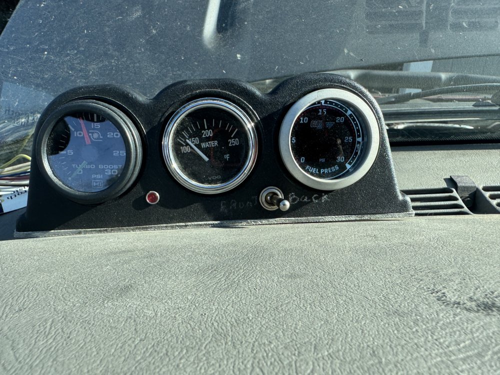

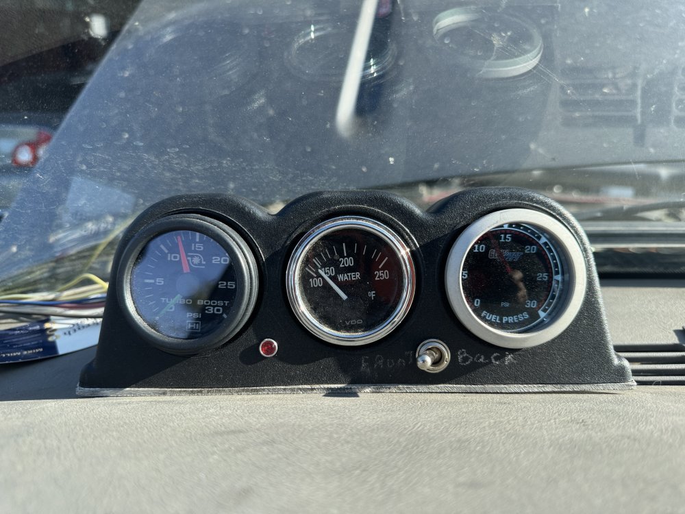

I finally dumped the big bucks and got the AirDog system.
@ak diesel driver He installed the Raptor system on His truck.
I think now I would most likely have also gone with the Raptor system but I wanted the best, and, like You will also hear in here, buy once, cry once.
Expand the pic to see a better view of the gauge needle on the right side gauge of the pod.
Pre FFM, or, right at the Air Dog pressure port.
And Post FFM, at the injection pump port, via a length of 5/16ths” SAE 30R9 fuel hose in order to get out where there is room for the snubber and the sending unit.
