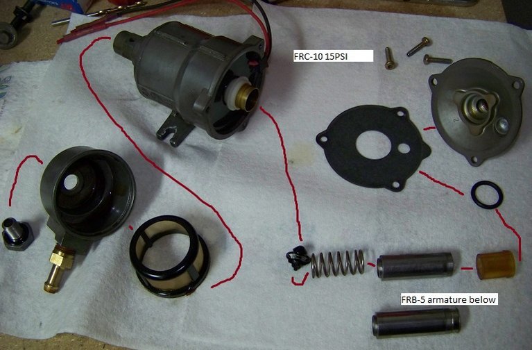

Walbro FRC-10? They back in stock somewhere?
