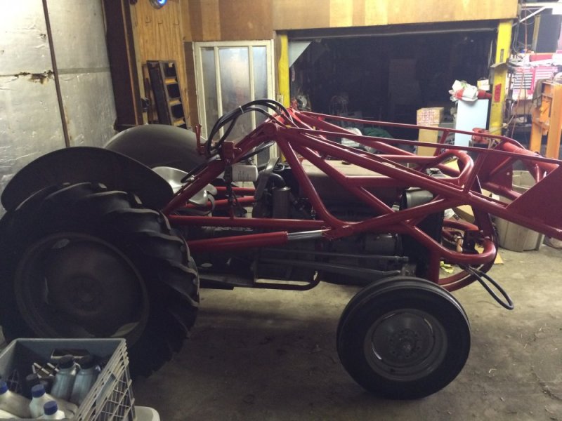

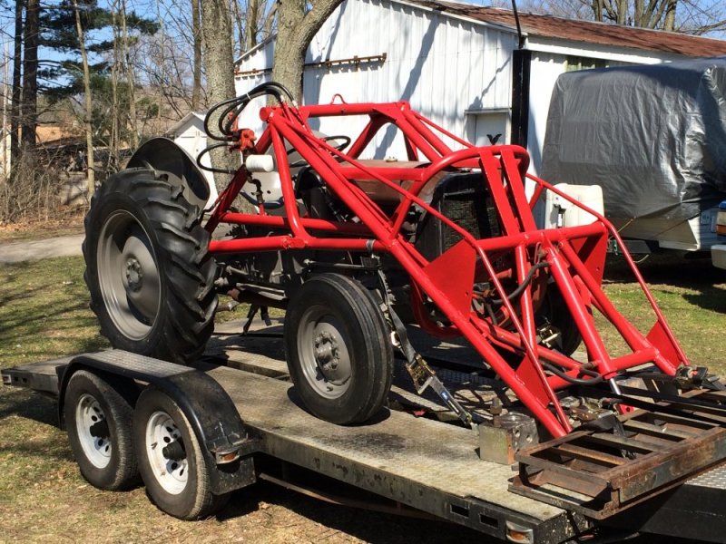

Yeah my dad has a '56 TO35 with a Ferguson loader on it and his loader has a lot less structure than mine. My loader has a tag on it, but it's painted over so I can't see the brand. I'm not sure if I could carefully remove the paint and be able to read the tag or not. I'm guessing not. I do really like that it's a power bucket instead of a trip bucket, it should be a lot handier.

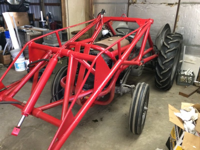

I did some work to the Turd Ferguson the last couple days. Last week we had 4” of wet, heavy snow. I didn’t have the chains on the garden tractor yet and frankly didn’t feel like messing with them. So instead I decided to just see what the bucket on the tractor could do. It actually got around really well, but the narro bucket left a lot to be desired.....but it got me thinking...... I remembered that I had a plow sitting around from a truck I parted out 10 years ago. So I dug it out and decided I would adapt it to work on the bucket frame.
The main bracket I had done in a day and I was pleased with how it looked and functioned. The construction is a little odd in some spots I’ll grant you, but I was trying to use as much material and parts as I already had to keep costs down.
18AC3982-89EF-4DE0-9EA4-7C0FDD6EF32B.jpeg2AF39056-6259-47E5-B219-987CB6708C23.jpeg1682C530-90F5-422C-9B12-B5920404F70B.jpeg
I cut an existing 3-point top link I had and extended it to use as the 3rd link for the plow mount.
At the end of the day I was laying out the bucket tilt cylinder to figure out how I could use it for blade angle. I thought something like this should work.
Day 2 (Sunday) I started making the mounts for the cylinder. I spent 5 hours working on them, tacked them to the frame.......and found out it just wasn’t going to work right - there was too much slop in the system as a whole to have it connect between the bucket frame and the blade frame.
Here is one of the pieces I made to attach one end of the cylinder to the blade frame and elevate it 4” yet still be strong.
So I reasoned that the cylinder had to be attached to the blade attachment bracket and not the bucket lift frame to reduce the total slop in the system. I had thought about this earlier, but didn’t love having the cylinder in this location. In the end, I realized it was the location that made the most sense. So I fabbed the additional bracketry and tacked it in place. It worked! So it was time to weld it out. I ended Sunday running out of wire, but it was dinner time anyway.
Tuesday I finished welding the bracket out. I tell you what, it was sure fun laying some real beads after all the sheet metal I’ve been welding lately!
C7EF6670-5756-4BE6-B3FC-2D368049F008.jpeg2DC735B2-4C80-4AF2-ABCA-20AF5DB73936.jpeg8339CAFB-5C30-4429-BB45-9CD35389DD25.jpeg23261A79-0378-4BC2-8B02-DCD0F0127D9B.jpeg
And then I got it installed.
Then I started working on the blade attachment point. I was able to reuse one of the other brackets I made Sunday so at least that wasn’t a total loss.
Finally last night it was all done. Well almost....I still need to make or buy the shoes so the whole blade isn’t scraping the driveway. I plow about 300’ of driveway and this should make the chore MUCH faster than doing it with the garden tractor. And I can use that extra time to work on the Tahoe. I can’t wait for our next snow!
