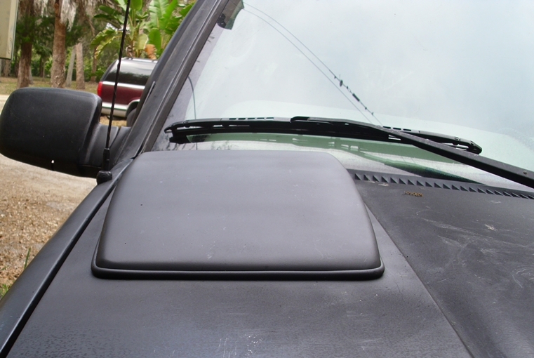

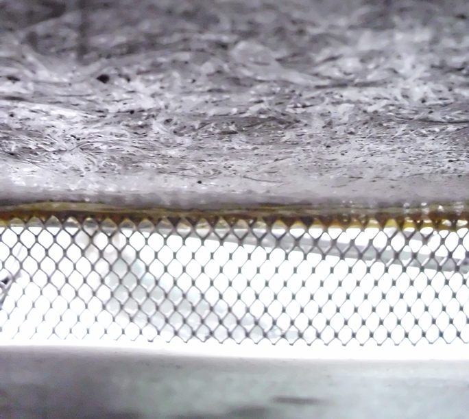

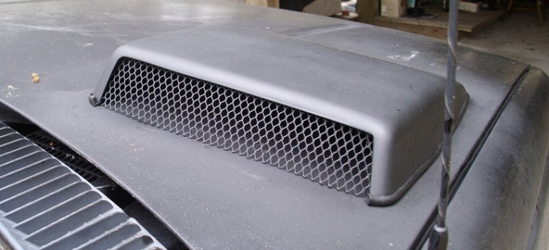

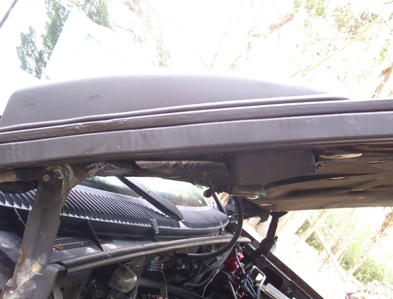

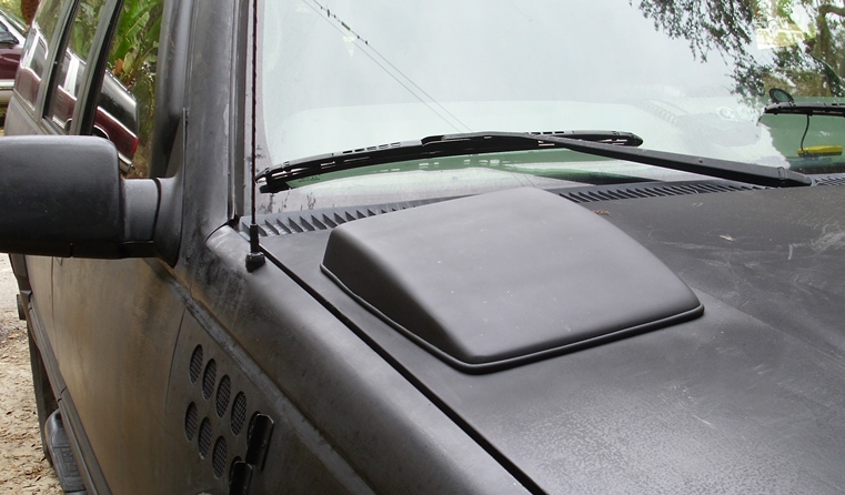

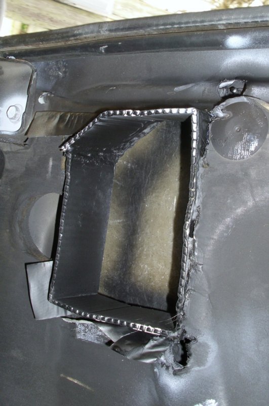

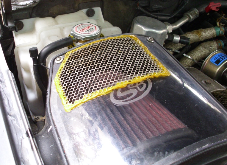

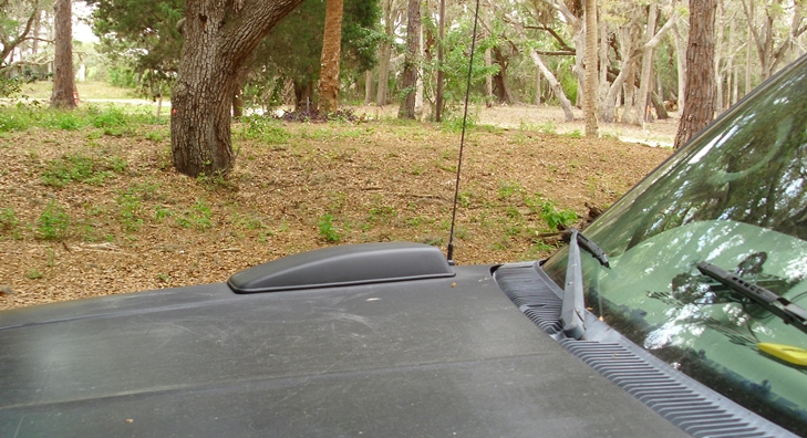

I have placed a small cowl induction scoop on my Burb that is ducted into the top of the S&B air box. While the S&B has the removable back to increase air flow it pulls hot under hood air my mod pulls only cold air and with my recent HX40 install the cowl induction scoop is ice cold to the touch after a hard run. I'll be making the opening to the airbox larger and angle the ductwork forward to allow even more air in.
The sides of my hood are sealed with door gaskets front to back to enhance underhood hot airflow through my primitive fender vents and I have placed gaskets around the scoop duct to seal it to the air box with hood closed.

I've wondered why I haven't seen this before. Cold air without restriction is a good thing. I think it looks good. I'm surprised to not see more snorkels out there from the offroad crowd.
Lower air temp makes a big difference in my truck. Summer / winter is a huge difference.
Is there not a concern about water when it rains or snows?
I live where it rains heavy then some more never an issue in the 2.5 years since install with the oiled gauze filter if it were to be a problem the filter would have came apart long ago, I still have the inside fender delivering air too. I thought a splash guard was needed but it works just fine. I'll be trying the paper filter too and will chime in on that adventure.
I will sometime in the future seal it off and use a 5" or 6" custom snorkle
Yep, big gulps of cool or cold filtered air makes all the difference!

I had tried to modify the S&B air box intake runner to the compressor as the design is a good one however too small for the 4" HX40 compressor intake so it will be 4" from the S&B box to the compressor, just waiting on silicone elbows.
I'll be enlarging the ducting from the cowl scoop and will enlarge S&B box cover to match larger size.
